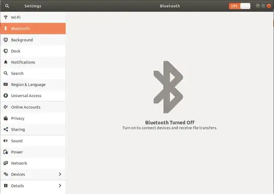

I have upgraded ubuntu 16.04 LTS to ubuntu 18.04 LTS and since then bluetooth is not discovering any devices.
Here are the steps I performed:
Turned bluetooth on from settings (seems lag to moving towards bluetooth option rather then other settings).
It's still not discovering any devices and also toggle of on off takes too much time to turn on device to discover but anyhow it's not discovering devices.
Before downgrading I have tried to run live ubuntu 18.04 LTS and this is what I get as in snapshot:
So according to bluetooth toggle it should be turned on but it still says bluetooth is off and not scanning any nearby device.
tried to run some of the below commands:
