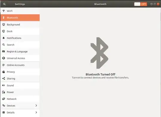

Edit:
You can see the even though the bluetooth switch is toggle on, it still shows the bluetooth is 'off'.
