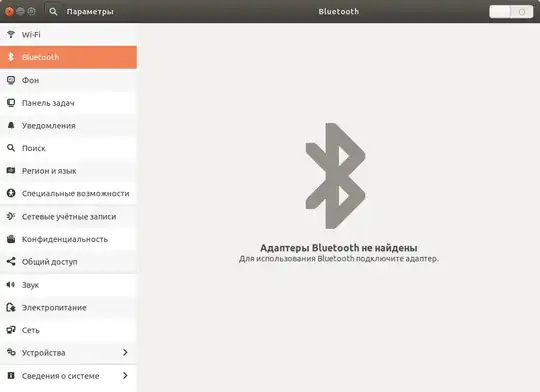

I try to connect Xbox one via Bluetooth adapter on my PC but before I get any problems (as usual) with the connection I have problems with even enabling Bluetooth: the button is 'off' and locked to change it. sorry for Russian

bluetoothctl - not responding
pruntoff@samus:~$ bluetoothctl
Waiting to connect to bluetoothd...

rfkill is installed but returns nothing.

pruntoff@samus:~$ sudo systemctl status bluetooth.service
● bluetooth.service - Bluetooth service
   Loaded: loaded (/lib/systemd/system/bluetooth.service; enabled; vendor preset
   Active: inactive (dead)
     Docs: man:bluetoothd(8)
