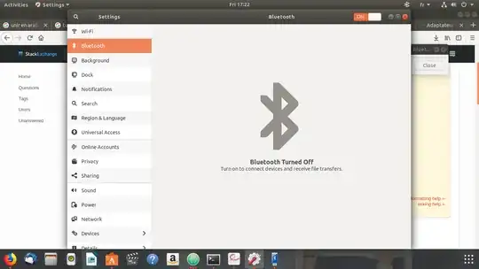

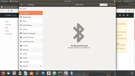

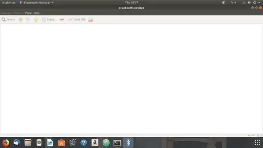

I've installed Ubuntu 18.04.I have a headset and I'm trying to connect it to my laptop(hp),when I try switching bluetooth to "On" it displays:"No bluetooth found,plugin a dongle to use bluetooth",I tried to install Blue Managerand blueZ but it displays me :No adapters !,Any one knows the steps of bluetooth configuration ?
1-No Bluetooth found Blueman is disable

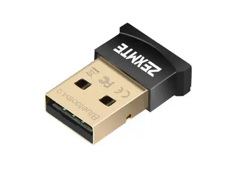

Edit 1: After some googling ,I found that I need to buy a Bluetooth adapter to connect my PC to headphone,I bought one (Bluetooth Dongle (Cambridge Silicon Radio, Ltd)) and it plugged to my pc and my bluetooth is "On" but my laptop can not detect my device. enter image description here After I plugged the bluetooth adpater and run lspci -knn | grep Net -A2; lsusb the result is :

When I run hcitool ,it does not detect the adapter (Bus 003 Device 003: ID 0a12:0001 Cambridge Silicon Radio, Ltd Bluetooth Dongle (HCI mode),and the result is :
 hcitool dev
Devices:

  • get yourself a Plugable usb bluetooth adapter (Amazon)
