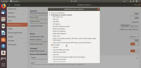

  • On Ubuntu 18.04 LTS, 20.04 LTS, 21.04 and 21.10 with GNOME desktop from GNOME Tweaks.
    1. Install it
      sudo apt-get install gnome-tweaks
    2. Then open GNOME Tweaks (gnome-tweaks).
    3. Select Keyboard & Mouse tab
    4. Click Additional Layout Options button
    5. Expand Switching to another layout
    6. Select Ctrl + Shift here
    See screenshot below:
    GNOME Tweaks - set <Ctrl+Shift>
    Or simply:
    gsettings set org.gnome.desktop.input-sources xkb-options \
      "['grp:ctrl_shift_toggle']"

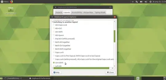

  • On Ubuntu MATE 18.04 LTS and newer versions this is possible from mate-keyboard-properties:
    1. Open MATE Control Center
    2. Click Keyboard
    3. Go to Layouts tab
    4. Click Options
    MATE Control Center keyboard
    Or simply:
    gsettings set org.mate.peripherals-keyboard-xkb.kbd options \
          "['grp\tgrp:ctrl_shift_toggle']"

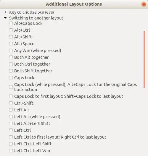

I found a partial workaround based on other answers for using Ctrl+Shift and shortcuts for GNOME in Ubuntu 18.04:
  1. Install GNOME Tweaks as proposed in N0rbert's anwser:
    sudo apt install gnome-tweaks
    then:
    • run it;
    • open "Keyboard & Mouse" tab;
    • click "Additional Layout Options" button;
    • instead of selecting Ctrl+Shift key combination in "Switching to another layout" of "Additional Layout Options" window simply untick all checkboxes:

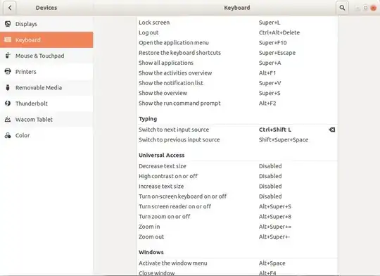

  2. Open "Settings" application from "Show applications" menu at the left bottom corner. Alternatively run a command in terminal:
    gnome-control-center
    then
    • go to "Devices" > "Keyboard" tab;
    • scroll to "Typing" group;
    • set shortcuts for "Switch to next input source" and "Switch to previous input source" (an order of keys DOES MATTER!!!):
    Keyboard settings

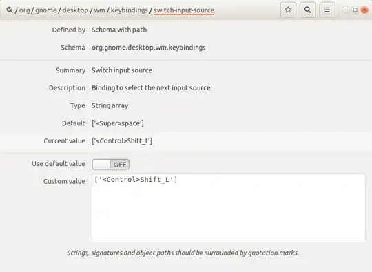

    If setting Ctrl+Shift or Shift+Ctrl shortcuts is impossible using this dialog (as it was in my case), then you can change these parameters in an alternative way:
    • install dconf-editor:
      sudo apt install dconf-editor
    • run it from terminal:
      dconf-editor
    • go to org > gnome > desktop > wm > keybindings;
    • select switch-input-source or switch-input-source-backward;
    • switch off "Use default value" and input "Custom Value": <Control>Shift_L for changing layout with Ctrl+Shift or <Shift>Control_L — for changing layout with Shift+Ctrl:
    dconf-editor
