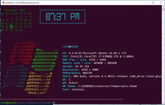

I saw a Ubuntu Bash under Windows 10 terminal splash screen here: Windows Subsystem for Linux display Linux distribution?
WSL Bash screeny
How can I change my ~/.bashrc to get a similar splash screen in regular Ubuntu that would look like this?:
Terminal Splash Screen

NOTE: Updated April 28, 2018 for Ubuntu 18.04 LTS
The heavy lifting is the splash component that shows this:
$ now
Weather report: Edmonton March 2018 ┌────────────────────────────┐ Su Mo Tu We Th Fr Sa │ ┏━┓╺┓ ┏━┓┏━┓ ┏━┓┏┳┓ │ \ / Sunny 1 2 3 │ ┃┃┃ ┃ ╹┏━┛┗━┫ ┣━┛┃┃┃ │ .-. -23--14 °C 4 5 6 7 8 9 10 │ ┗━┛╺┻╸╹┗━╸┗━┛ ╹ ╹ ╹ │ ― ( ) ― ↘ 22 km/h 11 12 13 14 15 16 17 └────────────────────────────┘ `-’ 14 km 18 19 20 21 22 23 24
/ \ 0.9 mm 25 26 27 28 29 30 31
Yes it really is -14 in Edmonton and feels like -23. A good time to spend the long-weekend inside playing the newly arrived Tomb Raider 2013! Maybe brush up on that Resume to move to Vancouver or Montreal...

Save the `~/.bashrc" file changes.
To display the Ubuntu information you need screenfetch:
sudo apt install screenfetch
There are similar display packages to screenfetch so shop around!
