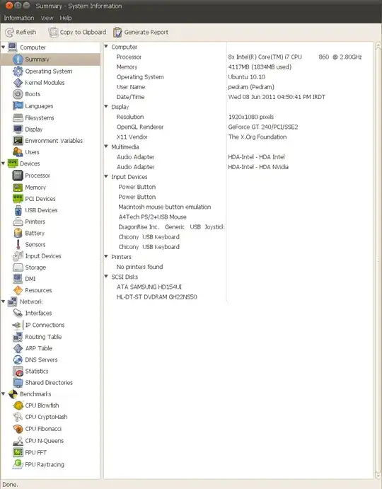

4. HardInfo
If you want something graphical, I suggest you look at hardinfo. You'll need to install it first:
sudo apt install hardinfo
You then just run it from the same terminal with hardinfo. I don't know that it has a menu location by default.
But it can give you slightly more information (boots, available kernels, etc) than the other options, as well as giving you similar lists of PCI and USB hardware like the first two commands.
It also provides some simple benchmarking. I think the developers aim to make it a replacement for Sandra (a popular Windows hardware information gathering tool).
It even has options to output a nice report that you can send to somebody (though it can easily be too much information):

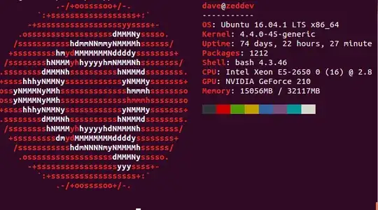

NeoFetch is a nice command line solution for high level information (if running Ubuntu 14.04 or higher).
To install you need to add the PPA first:
sudo add-apt-repository ppa:dawidd0811/neofetch
Then install:
sudo apt update && sudo apt install neofetch
Then run:
neofetch
Update:
neofetch is available in the Universe repository since 18.04.
A convenient way to present neofetch data is to use neofetch --stdout. This command produces output in plain text that can be copy/pasted into a question or answer here without needing to upload an image.
$ neofetch --stdout
dkb@kububb
OS: Ubuntu 18.04.2 LTS x86_64
Host: Inspiron 15-3567
Kernel: 4.15.0-48-generic
Uptime: 3 hours, 12 mins
Packages: 2352
Shell: bash 4.4.19
Resolution: 1366x768
DE: KDE
WM: KWin
WM Theme: Breeze
Theme: Breeze Dark [KDE], MyBreeze-Dark [GTK2/3]
Icons: Breeze-dark [KDE], Breeze [GTK2/3]
Terminal: konsole
Terminal Font: Hack 11
CPU: Intel i3-6006U (2) @ 2.000GHz
GPU: Intel HD Graphics 520
Memory: 1435MiB / 7846MiB

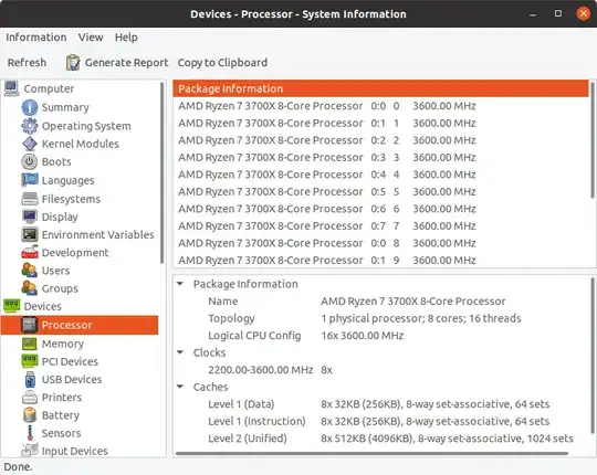

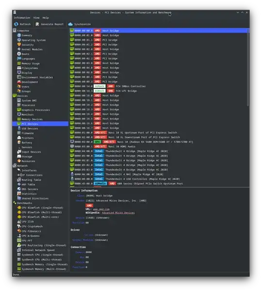

20.04 and later
In Ubuntu 20.04 and later install System Profiler and Benchmark (sudo apt install hardinfo).
HardInfo is a small application that displays information about your hardware and operating system. Currently it knows about PCI, ISA PnP, USB, IDE, SCSI, Serial and parallel port devices.

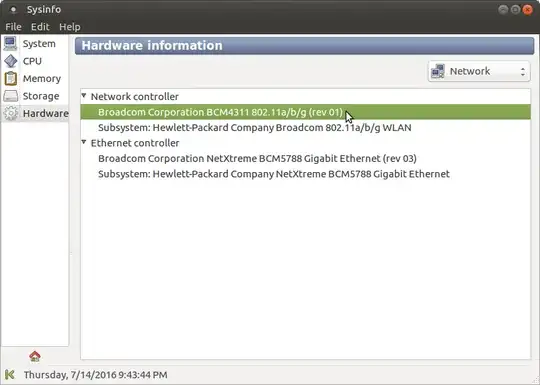

18.04 and earlier
Install Sysinfo (sudo apt install sysinfo) from the default Ubuntu repositories in Ubuntu 18.04 and earlier. Sysinfo is a graphical tool that is able to display some hardware and software information about the computer it is run on.
It is able to recognize information about:
  • System (Linux distribution release, versions of GNOME, kernel, gcc and Xorg and hostname)
  • CPU (vendor identification, model name, frequency, level2 cache, bogomips, model numbers and flags)
  • Memory (total system RAM, free memory, swap space total and free, cached, active, inactive memory)
  • Storage (IDE interface, all IDE devices, SCSI devices)
  • Hardware (motherboard, graphic card, sound card, network devices)
  • NVIDIA graphic card: only with NVIDIA display driver installed

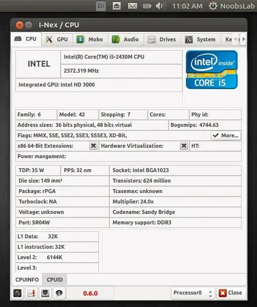

i-nex
I-Nex is free system info tool which is used to gather information on the main system components (devices) such as CPU, motherboard, memory, video memory, sound, USB devices and so on. The application allows through a tabbed clear interface to display information about the system hardware, this utility displays significant amount of system details. I-Nex utility continues to add new functionality, this time I-Nex included GPU information tab, and other various fixes. Besides being able to display hardware information, I-Nex can also generate an advanced report for which you can select what to include and optionally send the report to a service such as Pastebin (and others). It also features an option to take a screenshot of the I-Nex window directly from the application. The difference between I-Nex and the other hardware information GUI tools available for Linux is that the information is better organized and is displayed faster (than lshw-gtk for instance). Also, the hardware information is presented in a way that's easier to understand than other such tools.
cpu-g
enter image description here CPU-G is useful utility to show hardware information. It detects hardware and display details about everything, it shows information about CPU(Processor), RAM(Active/Inactive, Free, Used and cached), Motherboard and Chipset, Bios Details, Graphic card details, and details of installed Linux.
SOURCE http://www.noobslab.com/2014/01/cpuz-alternatives-inex-cpug-for-ubuntu.html

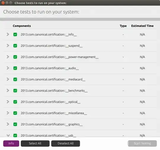

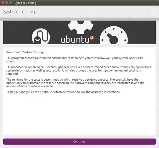

Is there a single utility to monitor most hardware's working status? Just like some software in Windows?
If you search for "system testing" in dash you will see a program that will check an insane amount of features. The 2nd image shows it will check suspend, power management, audio, usb, graphics, mediacards, dvd drives and much more.
If something is wrong related to a device it will inform you of it. A simple search on AU or posting a question specific to a problem shown at the results page should help investigate the related problem.

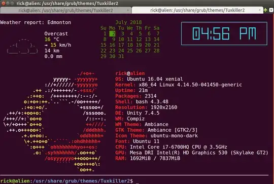

neofetch has already been mentioned but there is also screenfetch which provides even more information when you open your terminal after you put the command in your ~/.bashrc file:
Terminal Splash Screen
My terminal splash screen contains four components:
  • Weather
  • Calendar
  • Time (when terminal was opened)
  • screenfetch the system information utility
You can find details for doing this yourself in this answer:

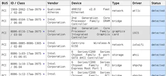

hw-probe tool: https://github.com/linuxhw/hw-probe
The tool creates a probe of the computer including outputs of hardware listers (hwinfo, dmidecode, biosdecode, etc.), several Linux diagnostics tools (smartctl, memtester, etc.) and system logs (dmesg, Xorg.log, etc.).
Probe example: https://linux-hardware.org/?probe=0b29192f95
I'm the author of this project, so feel free to ask any questions in comments!
