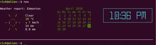

End Result
Applying fix of cal -h recommended below it worked fine until Ubuntu 18.04 LTS was released and tested on April 28, 2018. Now the fix recommended by @Steve H is used:
Some are curious about the what the code does so I provided the screen shot above. Others have asked for the full code and it is available here:How can I get this terminal splash screen?
