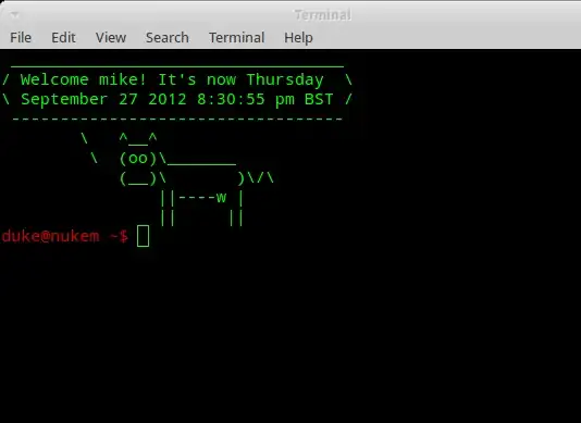

Instead of adding the date to the prompt itself, you could add the date just before your prompt by placing the following line at the top of your .bashrc. For it work you will also need to install cowsay. It's a fun way of displaying the date while keeping a short prompt:
cowsay "Welcome $USER! It's now $(date '+%A %B %d %Y %r')"
In its current form it will work on anyone's system without amendment as it reads the $USER and the date variable from the current environment.

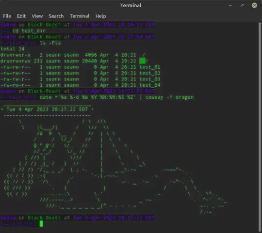

I realize I'm a little late to this party, but by setting PS1 in $HOME/.bashrc like so:
PS1="\e[1;38;5;56;48;5;234m\u \e[38;5;240mon \e[1;38;5;28;48;5;234m\h \e[38;5;240mat \e[1;38;5;56;48;5;234m\[\$(date +'%a %-d %b %Y %H:%M:%S %Z')\\] \e[0m\n\e[0;38;5;56;48;5;234m[\w]\e[0m "
I get a full-colour-formatted, time-stampped prompt like so: terminal screenshot
Here's how it breaks down:
  • \e[1;38;5;56;48;5;234m\u is the colour-coded username, where \u would be just the username
  • \e[1;38;5;28;48;5;234m\h is the colour-coded hostname, \h is the hostname
  • \e[1;38;5;56;48;5;234m\[\$(date +'%a %-d %b %Y %H:%M:%S %Z')\\] is the colour-coded full-date-and-time insert in 24-hour time where [\$(date +'%a %-d %b %Y %H:%M:%S %Z')\\] would be the same, but monochrome, and, alternatively, you could just use \d to print the date in your default system format
  • \n moves to the next line
  • [\w] shows the current working directory encased in square brackets
If you want solid tips for using colour codes, I used this guide as a reference for my colour codes.

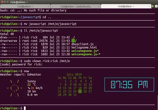

My time is similar to the cowsay answer above. You need to put now your ~/.bashrc but you can also call it from the terminal by typing now.
Here's a screenshot:
The bash code is posted in this very detailed answer:
