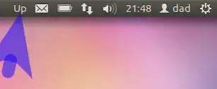

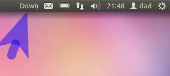

Whilst you mentioned you wish to do this in the network applet - I don't think you can do this. Here is an alternative.
internet up
internet down
how to for 11.10 & 12.04
It requires an indicator from a PPA together with a custom ping test script:

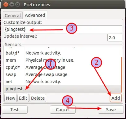

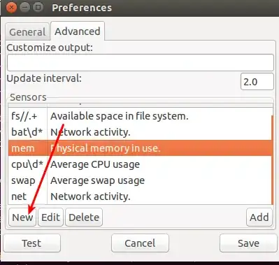

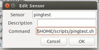

Then in the indicator-preferences click New:
Then enter the details as shown:
i.e. use the command
$HOME/scripts/pingtest.sh
Click OK, followed by the following actions 1,2,3 & 4:
enter image description here code
