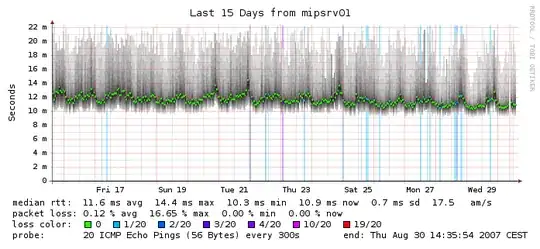

Smokeping is realtivly easy to setup tool which can monitor and send email alarms.
Here is a demo of its web-interface.
