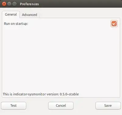

Click anywhere on the indicator to open its menu, and select "Preferences". In the "General" tab, enable "Run on startup:"

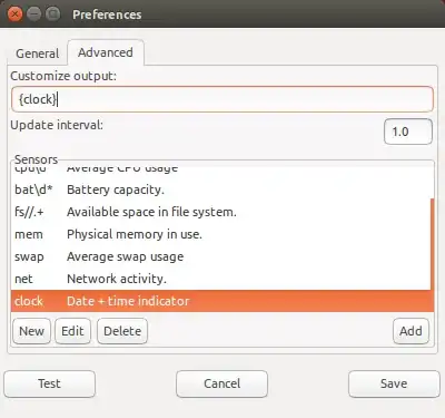

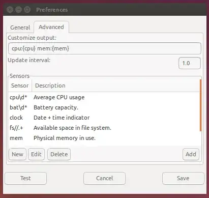

Go to the "Advanced" tab and click "New".
Name your new sensor "clock", give it a description, and type the following code into the "Command" field.
 date +%a\ %b\ %d\ %r
Click "OK"
On the "Advanced" tab, in the "Customize output:" field, delete cpu:{cpu} mem:{mem} and type
{clock}
Change the update interval to 1.0, and click "Save".
You should now have a day + date + time indicator in your Unity dash panel.
