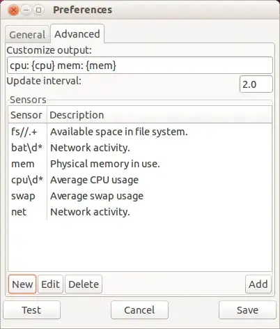

System Monitor Indicator comes with options to display CPU load, memory usage, and other system stats, but currently does not include an option to display temperature (of the CPU, HDD, SSD, GPU, etc.).
There seems to be functionality built in for adding additional sensors by applying a command (by clicking "New"). However, I don't know how, and I cannot find any documentation that describes this feature.

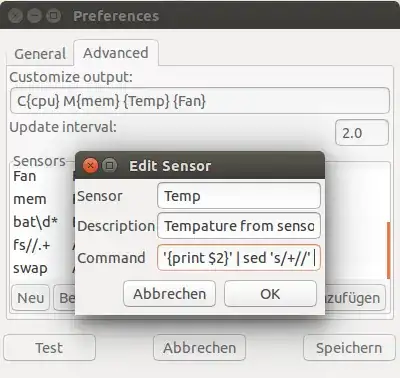

System Monitor Indicator is quite simple / flexible. You can add basically any script as custom sensor. The output it produces will then appear where you put its placeholder. I am using this to extract information from the output of sensors like this:
sensors | grep temp1 | awk '{print $2}' | sed 's/+//'
to exctract the temperature or
sensors | grep fan1 | awk '{print $2}'
to extract the fan speed.
Just click on New, enter a name and a description and the respective lines from above under Command as shown here:
PS: After upgrading from Ubuntu 12.04 to 14.04 the tool seemed to have problems to read the configuration file, resulting in a crash when I tried to add sensors. Removing .indicator-sysmonitor.json from my home directory fixed this.

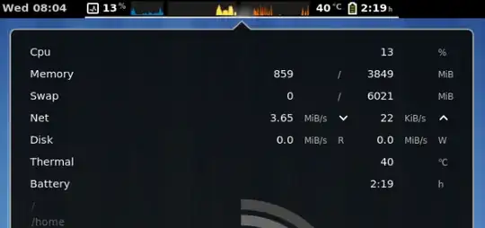

As said here you have:
system-monitor GNOME Shell extension
screenshot
