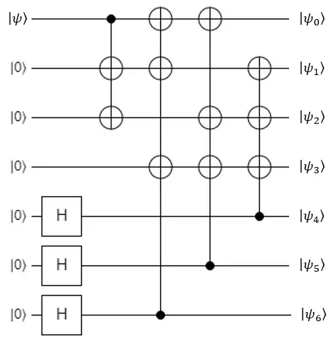

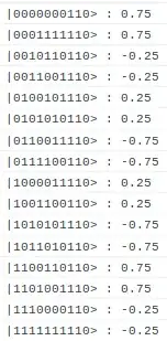

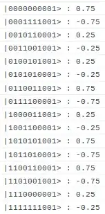

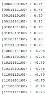

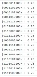

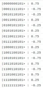

Following this, we perform an algebraic verification of the 7-bit encoding and decoding:
Step 0:
$$(a|0\rangle + b|1\rangle)|000000\rangle $$ $$=a|0000000\rangle + b|1000000\rangle $$
Step 1:
$$a|0000\rangle\frac{1}{\sqrt2}(|0\rangle + |1\rangle)\frac{1}{\sqrt2}(|0\rangle + |1\rangle\frac{1}{\sqrt2}(|0\rangle + |1\rangle) + b|1000\rangle\frac{1}{\sqrt2}(|0\rangle + |1\rangle)\frac{1}{\sqrt2}(|0\rangle + |1\rangle)\frac{1}{\sqrt2}(|0\rangle + |1\rangle) $$
$$=(1/ \sqrt8)(a|0000000\rangle + a|0000001\rangle + a|0000010\rangle + a|0000011\rangle + a|0000100\rangle + a|0000101\rangle + a|0000110\rangle + a|0000111\rangle + b|1000000\rangle + b|1000001\rangle + b|1000010\rangle + b|1000011\rangle + b|1000100\rangle + b|1000101\rangle + b|1000110\rangle + b|1000111\rangle)$$
Step 2:
$$(1/ \sqrt8)(a|0000000\rangle + a|0000001\rangle + a|0000010\rangle + a|0000011\rangle + a|0000100\rangle + a|0000101\rangle + a|0000110\rangle + a|0000111\rangle + b|1110000\rangle + b|1110001\rangle + b|1110010\rangle + b|1110011\rangle + b|1110100\rangle + b|1110101\rangle + b|1110110\rangle + b|1110111\rangle) $$
Step 3:
$$(1/ \sqrt8)(a|0000000\rangle + a|1101001\rangle + a|0000010\rangle + a|1101011\rangle + a|0000100\rangle + a|1101101\rangle + a|0000110\rangle + a|1101111\rangle + b|1110000\rangle + b|0011001\rangle + b|1110010\rangle + b|0011011\rangle + b|1110100\rangle + b|0011101\rangle + b|1110110\rangle + b|0011111\rangle)$$
Step 4:
$$(1/ \sqrt8)(a|0000000\rangle + a|1101001\rangle + a|1011010\rangle + a|0110011\rangle + a|0000100\rangle + a|1101101\rangle + a|1011110\rangle + a|0110111\rangle + b|1110000\rangle + b|0011001\rangle + b|0101010\rangle + b|1000011\rangle + b|1110100\rangle + b|0011101\rangle + b|0101110\rangle + b|1000111\rangle)$$
Step 5:
$$(1/ \sqrt8)(a|0000000\rangle + a|1101001\rangle + a|1011010\rangle + a|0110011\rangle + a|0111100\rangle + a|1010101\rangle + a|1100110\rangle + a|0001111\rangle + b|1110000\rangle + b|0011001\rangle + b|0101010\rangle + b|1000011\rangle + |1001100\rangle + b|0100101\rangle + b|0010110\rangle + b|1111111\rangle) $$

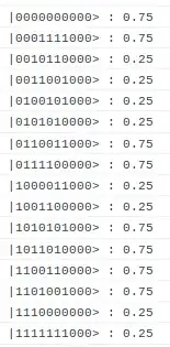

$$=\frac{a}{\sqrt8}\begin{bmatrix}|0000000\rangle \\ |1101001\rangle \\ |1011010\rangle \\ |0110011\rangle \\ |0111100\rangle \\ |1010101\rangle \\ |1100110\rangle \\ |0001111\rangle \end{bmatrix} + \frac{b}{\sqrt8}\begin{bmatrix}|1110000\rangle \\ |0011001\rangle \\|0101010\rangle \\|1000011\rangle \\ |1001100\rangle \\ |0100101\rangle \\ |0010110\rangle \\ |1111111\rangle \end{bmatrix}$$
Decoding circuit:
Step 0:
$$(1/ \sqrt8)(a|0000000000000\rangle + a|1101001000000\rangle + a|1011010000000\rangle + a|0110011000000\rangle + a|0111100000000\rangle + a|1010101000000\rangle + a|1100110000000\rangle + a|0001111000000\rangle + b|1110000000000\rangle + b|0011001000000\rangle + b|0101010000000\rangle + b|1000011000000\rangle + |1001100000000\rangle + b|0100101000000\rangle + b|0010110000000\rangle + b|1111111000000\rangle) $$
Step 1, 2, 3, 4, 5, 6, 7, 8, 9, 10, 11, 12:

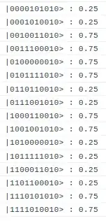

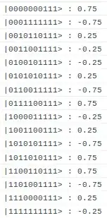

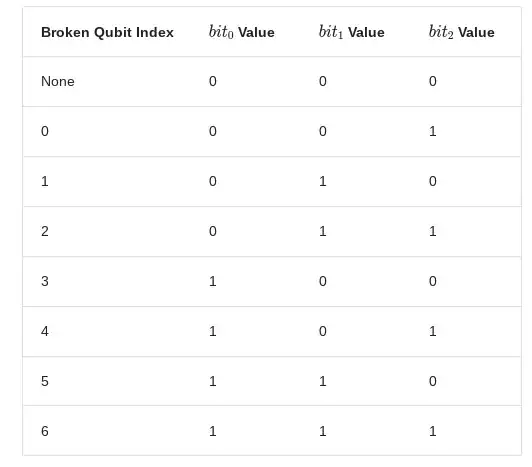

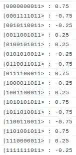

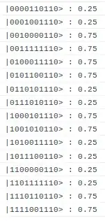

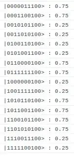

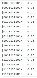

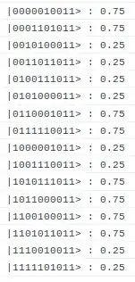

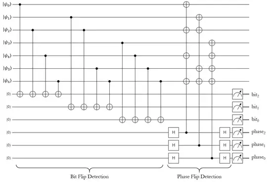

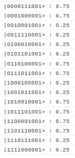

Single bit-flip error introduction
enter image description here enter image description here enter image description here enter image description here enter image description here enter image description here enter image description here

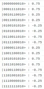

Single phase-flip error introduction

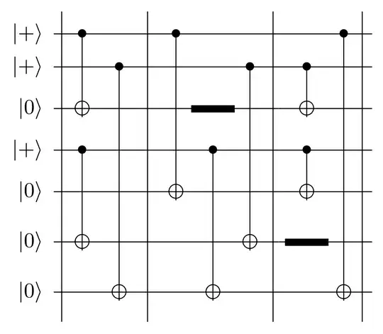

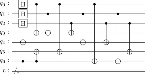

A concrete circuit allowing to encode the logical $|\bar{0}\rangle$ can be as follow (source, page 33 of this paper).
Now, in practice, this circuit is not fault-tolerant, which means that a single error introduced by a cNOT gate can propagate toward all the physical qubits (ruining your protection). You could also initialize as Craig and the other post your link refer to proposed (by measuring the stabilizers). However, I also think that for this specific code it will not give you a fault-tolerant initialization. This is because to perform this measurement you would need extra ancilla qubits that would have to interact with your original qubit and that could create more than one error on your logical data qubit during their interactions (making the state un-correctable). ( * )
If you are not worried by having a fault-tolerant initialization, any of the answers is good.
( * ) I am thinking about a brute force measurement of all the stabilizers. What I mean is that some care must be done to do it in a fault-tolerant manner.
