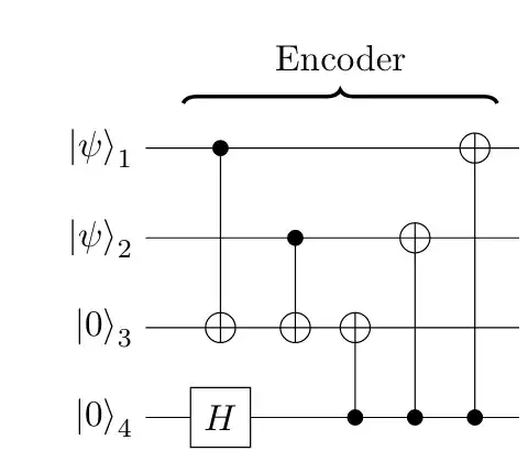

For the famous $[\![4, 2, 2]\!]$ code, there is a circuit to encode two physical states into the logical state (from Roffe's work):
As $[\![m, m-2, 2]\!]$ is a class of error-detection code, I am wondering if there is a known similar encoding circuit for $[\![6, 4, 2]\!]$ code. Mathematically, the unitary always exists. But I failed to find any similar explicit circuit from the existing literature.

We can obtain an encoding circuit for the $[\![m,m-2,2]\!]$ code for any even $m$ by generalizing the circuit displayed in the question. More precisely, for every new qubit we prepend a CNOT gate with the new qubit as the control and the second from the bottom qubit as the target and append a CNOT gate with the bottom qubit as the control and the new qubit as the target.
We can verify that the circuit is correct by propagating $I^{\otimes m-2}\otimes Z\otimes I$ and $I^{\otimes m-2}\otimes I\otimes Z$ through the circuit and checking that we obtain the appropriate stabilizer generators $Z^{\otimes m}$ and $X^{\otimes m}$.
