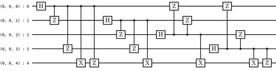

Using
import stac
cd = stac.CommonCodes.generate_code('[[5,1,3]]')
cd.construct_encoding_circuit()
cd.encoding_circuit.draw()
Encoding circuit for 5,1,3 code
You can easily rewrite this circuit in qiskit. In fact, here is the QASM for it
print(cd.encoding_circuit.qasm())
OPENQASM 2.0;
include "qelib1.inc";
qreg q[5]; creg c[5];
h q[0]; cz q[0],q[1]; cz q[0],q[3]; cx q[0],q[4]; cz q[0],q[4]; h q[1]; cz q[1],q[2]; cz q[1],q[3]; cx q[1],q[4]; h q[2]; cz q[2],q[0]; cz q[2],q[1]; cx q[2],q[4]; h q[3]; cz q[3],q[0]; cz q[3],q[2]; cx q[3],q[4]; cz q[3],q[4];
