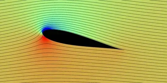

Streamline diagrams depict a finite number of lines which are tangential to the current $\mathbf{j}=\rho_\text{fluid}\mathbf{v}$ at all points. That means a particle that starts on a streamline will stay on it as the fluid flows.
enter image description here (Image source)
The fun starts when streamlines suddenly get closer to each other. This means that either the fluid has been compressed, or that the unit volume of fluid has been stretched so it is longer along the streamlines (as in e.g. this diagram), and therefore the fluid is going faster. Either way, the fluid current density $|\mathbf{j}|$ increases.
This can be made more precise. In the image of the airfoil above, for example, the streamline 'seeds' (the points on the left at which the streamlines start) have been chosen so that the fluid flowing per unit time into the image from the left in between any two adjacent streamlines is constant. Because no fluid flows across a streamline, this rate of fluid flow must remain constant. Because of that, when the streamlines are closer together, the rate of fluid flow per unit area (i.e. the current density) is bigger.
(In addition to that, if there are sources or sinks where the fluid is created or destroyed, then you may need to introduce or remove some streamlines, because in such a situation the rate of fluid flow between the original streamlines is of course no longer conserved.)
Because of this fact, if you are given a pictorial representation of the streamlines of a fluid flow, then you can use it to reconstruct an approximation of its current density field. Its direction is given by the streamlines, and its magnitude is dictated by the spacing to the neighbouring streamlines. This is of course only approximate: you can try and interpolate the values between two streamlines, but you're missing information. You can try and improve your approximation by taking a finer grid, i.e. decreasing the flow rate needed to mark the next streamline, and that will give you better precision (but of course it will still be an approximation).
Conversely, to produce a streamline diagram you must first agree on the flow rate which should be taken until the next streamline. After that, you start off your "official" streamlines at one end of the flow, with the appropriate spacing, and you follow them through to the end. (Note, though, that because of the conservation of rate-of-flow-between-adjacent-streamlines, you can also start off your streamlines in the middle of the flow, as long as you space them appropriately). There will then be a finite number of "official" streamlines, as well as an infinite number of potential streamlines you could draw in between them. It is of course the "official" ones that you should use when estimating the current density from the diagram.
You can then make the spacing between "official" streamlines smaller, and it will get you a more accurate representation of the flow field. Even better, if your streamlines are really close together, it begins to make sense to speak of the local density of official streamlines. If the fluid slows down by a half from one region into another, and your streamlines are still very close together, then you'll find that there are twice as many in a given finite-and-small-ish area where the fluid is fast compared to where it is slow.

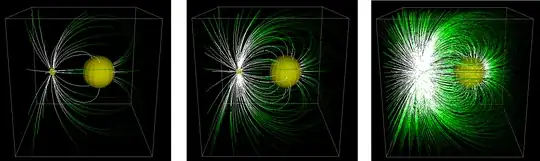

One useful tool to visualize this limit is Paul Falstad's 3-D Vector Fields Applet. For one, it lets you visualize electric fields as the velocity fields of fictitious particles, and it lets you play around in three dimensions with many of the standard electrostatics configurations, but most importantly it lets you increase and decrease the field line density:

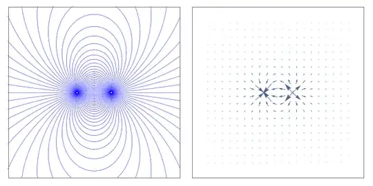

I would also like to set down here some thoughts on representation. Through the procedure I outlined above, it is indeed possible to reconstruct an approximation to the electric field in a region from a diagram with a finite number of field lines. Thus, these two representations of the same dipolar electric field are essentially equivalent*:
Mathematica graphics
However, just because they contain the same information, it doesn't mean that they are equally useful. Field line diagrams are very useful for forming an intuitive idea of what direction the field points in and its relative strength in different regions, but it is a terrible tool for estimating the superposition of two fields (for which a vector field representation is better), and it creates several incorrect intuitions. At the end of the day, even though we can indeed 'explain the force of gravity from the field representation without using the mathematical equation', attempting to do so turns out to be absolutely not worth the trouble. You should really see the field lines as merely a representational tool, and stick to the mathematics of the vector field for 'what the field really is'.

Thus, to correctly estimate the field from such a diagram, you need to work from a 3D diagram like the ones produced by Paul Falstad's simulator, which produced the graphics above, ( or this one, if you have the cash), or you should work in 2D systems (i.e. 3D systems with a translational symmetry).

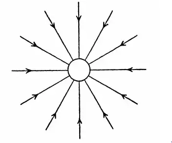

You are absolutely right that the amount of filed lines is infinite, nevertheless thinking about "the density of field lines" is still useful in many applications. Here is an approach that hopefully will clarify things. Let's think of the electric field of a single charge. We choose to draw n lines of it just for illustration. In the figure, $n=8$.
The electric field of a point particle with 8 field lines drawn.
Now imagine a sphere around the charge wih radius $r_1=1\:\mathrm m$. What is the number density per surface area of the fields line we have chosen on that surface? Obviously $$\rho_1=\frac{n}{4\pi r_1^2}=\frac{8}{4\pi} \:\mathrm m^{-2}.$$ For a sphere with radius $r_2=10m$ this quantity is $$\rho_2=\frac{n}{4\pi r_2^2}=\frac{8}{400\pi} \:\mathrm m^{-2}.$$
How do these number densities compare? Which one is bigger and how much bigger is it? Note that $$\frac{\rho_1}{\rho_2}=\frac{\frac{n}{4\pi r_1^2}}{\frac{n}{4\pi r_2^2}}=\frac{r_2^2}{r_1^2}$$ which tells us that $\rho_1$ is bigger than $\rho_2$ by a factor of $\frac{r_2^2}{r_1^2}$ ($=100$ in the example). Now comes the crucial part of the argument:
We note that the above ratio is independent of $n$ so if we had chosen to draw 10, 100 or 10 billion lines it wouldn't have made a difference. Even if we chose to take n to infinity the result still wouldn't change because it doesn't depend on $n$! In that sense, it makes sense to say that the density of the field lines decreases, even if the number of field lines is infinite.
