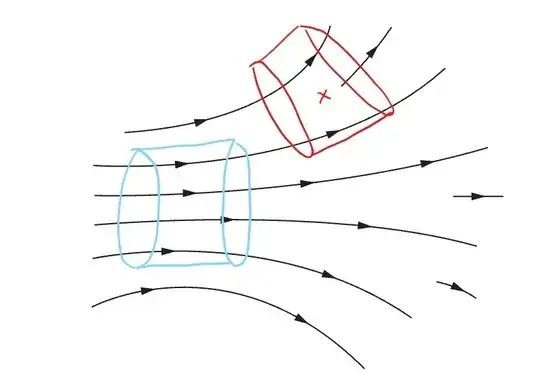

Looking at Fig. 1.2 from the Feynman lecture, if I draw a closed surface (blue cylinder in the picture), the flux through it in the plane of the page is 0, because there is as many field lines entering it as there are exiting it.
However, if I draw another closed surface (red cylinder in the picture) there are more field lines exiting it then entering it in the plane of the page.
This could be explained for example by a positive charge just above the plane of the page (just above the red x). The positive charge will have electric field lines emanating from it. On the left border, this flux will cancel out with some of the incoming flux. On the right border, the flux from the charge will add to the other field lines. There will therefore be more field lines at the right border than the left border, since there is a stronger magnetic field there. This is represented by having a higher concentration of electric field lines.
Feynman Fig. 1.2 with added closed surfaces
Now, if the charge is enclosed by the red surface, by Gauss's law there will be a net flux through the surface. This makes sense. If the charge is not enclosed by the red surface, all we know is that the net flux through the red surface is 0. We only see a part of the flux through the red cylinder in the depicted plane.

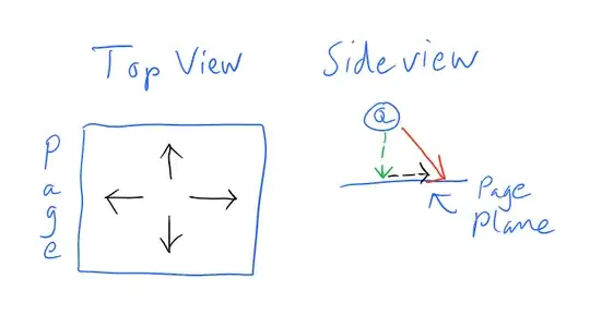

The image below shows how a charge outside the plane of the page will create an electric field line appearing "out of nowhere" on the page. The charge causes an electric field at the tip of the red arrow. This field has two components: one that is perpendicular to the plane (green) and therefore invisible in our plane, and one that is in our plane (black) and therefore visible in the diagram.
a charge outside of the plane causes an electric field in the plane
So in conclusion, electric field lines only begin or terminate at charges, but if we want to depict a 3D field in 2 dimensions, we might not always be able to see the charge the field started from in the plane of the page.
