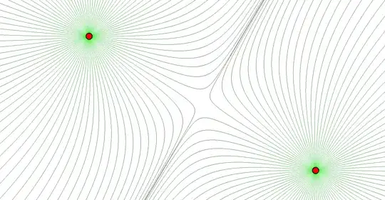

I have rendered an image, where two positive charges with equal electrical charges are present: my application's output I was told that the picture is not correct, because the field lines are getting "concentrated", so if I were to look at this from very far away, I would never see an (almost) perfectly symmetrical picture - it would never be (almost) the same as a single charge with twice the electrical charge.
Here's a picture which (probably) meets such a criteria: (source) picture from someone else
Are both of these images correct - do both of these images correctly show (some of) the field lines of the two charges? Why (not)?
My guess is that both of these are correct, but in the second image only specially selected field lines are drawn, so the outcome contains such evenly distributed field lines, but I have no proof which backs this theory up.

A better question would be whether the density of the field lines should be proportional to the field-strength if the field lines start out from the charges at regular angle intervals.
The answer is yes, but: for a 2D plot, when correctly plotted, this is only true for the 2D equivalent of the point charge, i.e. for (combinations of) line charges whose field goes down as $1/r$. This is explained in more depth in the last section of this old answer of mine, but the short of it is that for lines that expand out (or converge in) radially at equal angular intervals, the number of field lines per unit length that cross a given circle of radius $R$ (itself proportional to the field strength) goes down as $1/R$, which corresponds to line charges, not to point charges in 3D.

  • At small zoom levels, however, the field is stronger at the horizontal axis than it is at the vertical ends of the outer circle. (This is because, at the vertical end, the horizontal components of the field cancel out, and the vertical components are not as big.) This means that the line density is larger at the horizontal ends than at the vertical ends.
  • In fact, the line density has a local minimum at the vertical ends. This is entirely inconsistent with your first plot, and a surefire way to diagnose it as a buggy plot. (As to what the bug is, it's impossible to tell without seeing the code.)
