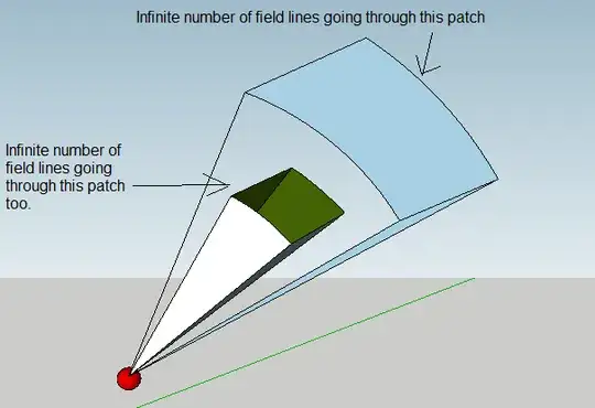

I've already went through this post. Yet, I still can't understand the meaning of "density" of electric field lines whose number is, in reality, infinite.
One of the answers , for instance, states that the ratio of two densities is independent of the number of field lines, so even when their number is infinite, they would always end up canceling each other when computing the ratio of two densities ( for the field lines generated by a point charge), the mathematical proof of this statement makes sense. However, in reality, the number of field lines is infinite, and field lines don't cancel each other, so even if we get further from our point charge, the number of field lines per unit area would still be infinite, no matter how far or near we're from the source.
Am I missing something?

Even though it is infinite, you can not draw infinite lines on the paper. So, the density is better defined as the number of visible lines (that are finite) that passes through a given area (for example, a 1cm by 1cm square). enter image description here
In places far from the source, there would be less lines passing inside the square than a place very close to the source.
The primary concept you are looking for is flux density, which is equivalent to the field strength. The flux of the field is well defined without infinities. The density of a finite number of field lines on a diagram gives you a little bit of information about this quantity. This information is still useful even though it is not complete. It is like how a diagram with a finite number of field lines gives you a little bit of information about the direction of the field, but you still need to extrapolate in the regions where a field line is not drawn.
The reason the field lines can tell you about flux and thus the field strength at all, is because the field lines obey a kind of 'trivial' Gauss's law, where in any gaussian surface which doesn't enclose a charge the sum of lines entering and leaving is equal to zero. The intersections by field lines work exactly like the flux itself, and so we can get some information about flux density through a diagram with a finite number of field lines.
