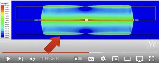

I’m going to carefully choose just one of the issues you raise, which I think is relevant to your entire question:
Initial EM field: Looking at Veritasium thought (and also real, albeit scaled-down) experiment, after the switch is closed, an EM field radiates outward (at the speed of light) from the switch towards the load. This field, while generating a current which is orders of magnitude above leakage current, still generates only a transient (weak) current, which is greatly surpassed by the current in the stationary regime. Thus, it seems safe to say that this transient does not carry the majority of the energy.
The initial (“transient”) current is only weak because of the impedance mismatch at the end of the transmission line. You can get a hint of this if you watch starting at 12:00, where a simulation of the electric and magnetic fields in the circuit shows the switch-is-closed signal propagating down the transmission line, reflecting off of the ends, and then meeting again in the middle. If you watch for two minutes, you’ll see a simulation showing the “circuit,” where the two long wires are connected at the far ends, next to an “antenna,” which is exactly the same as the other long wire except its distant ends are free. The responses are almost exactly the same before the signal reflects from the ends:
magnetic field intensity during transient
A few minutes later, the video derives the “transmission line” model, and then discusses matching the impedance in order to produce the most power during the transient. The transmission line in either direction is measured to have an impedance of about 550Ω, so a load of 1100Ω is used.
Let’s think about why we get a reflection off of the ends. If the circuit is closed, like the loop in the screencapture above, the potential difference at the end (“terminus”) of the transmission line is constrained to be exactly zero. The electromagnetic field conspires to maintain this zero voltage by producing a reflected wave whose electric field is the opposite of the electric field of the incoming wave. Once the reflections have met in the middle, then all of the voltage drop is across the central load, whose current then increases.

In the open-circuit case, the “antenna” in the screencapture above, the condition at the end of the transmission line is that the current through the terminus is exactly zero. For the open-ended transmission line, the electric field in the reflected wave has the same sign as the incoming wave, because no charge flows across the gap. The steady-state equivalent circuit is
