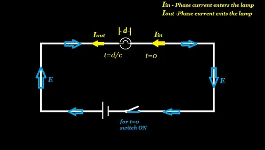

Ve's thought experiment, correct explanation
Note: Electron flow of current is used in the above schematic
Assuming our conductive circuit has ideally, inductance $L=0$ and capacitance $C=0$ and therefore $t=L/C=0$, as soon as the switch is brought in the closed position (assuming this is done instantaneous at time t=0 as shown in the figure), the potential difference is present at any segment of the circuit meaning an electric field vector E is generated simultaneously at any point of the circuit including the incandescent lamp which is actually a resistor connected in series in the circuit.
There is no time delay in this case described for the electric field to extend out from the positive lead of the battery and circulate along our circuit, as some would believe will hold also in this case described, confused with the EM waves radiation from an antenna and propagation of electromagnetic waves in space in general. The electric potential is applied as soon as the switch is closed and the d.c. transient signal due the switching is generated simultaneously at any point of the circuit shown.
There is no violation of any speed of information transfer limit c, since a potential is not energy although a potential difference between two connected points in a circuit can create an energy flow thus an electric current.
Therefore, the correct answer according to all technical circuit conditions and ideal assumptions described in Ve's video and herein is as following:
  1. t=0, when assuming that the lamp lights up as soon as the phase current enters the lamp Iin. There is no time delay, the lamp will light up instantaneously.
  2. t=d/c, time delay when assuming that the lamp lights up as soon as the phase current exits the lamp Iout. Where d is the total length of the filament inside the lamp and c the speed of light.
Notice here, that in case 2 above assumption that the lamp would light up only if the phase current would pass through the total resistive path of the lamp, although the electric field is instantaneously applied to all points in the circuit as described, the force $E=qE$ on each charge still propagates form charge to charge at the speed of light c ideally assumed in our system or realistically speaking, at the speed of light inside the wire.
Conclusion: Non-intuitively, the speed of the conductive circuit path in Ve thought experiment with all the above assumptions explained herein, will be faster than the 1m air distance cap, path! Thus the lamp will start to light up continuously (i.e. steady state) at time less than 1m/c, thus t<3.3 ns. Meaning, in this scenario explained, the lamp would reach steady-state operation before the transient wireless EM pulse generated covers the 1m distance at ~1m/c time and reaches the lamp.
