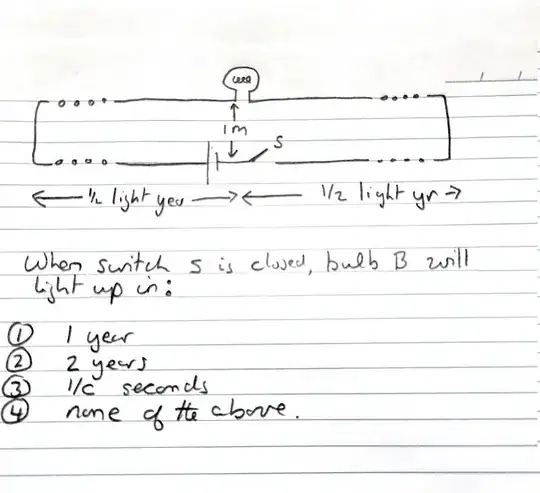

This is a question from the YouTube science content channel Veritasium. The below image shows the question.
Enter image description here
The question is about when will the bulb begin to glow after the switch is turned on. The presenter argues that it will take $1/c$ seconds for the bulb to light up, since the separation between load and source is only 1 m, and by Poynting's theorem, the energy will flow from source to load in the direction given by the Poynting vector, and since there is only 1 m separation, it will ideally take $1/c$ seconds for energy to reach the bulb and the bulb will light up. This kind of makes sense, and there are professors of EE and Physics appearing on the video, supporting the argument.
Now, what from my understanding, the Poynting vector only gives a direction in which the energy is flowing. It does not say anything about the time taken for it to each the destination. Also for the bulb to light up, the filaments have to be heated, so there must by a current flow in the filament, which will not happen until an electric field is present inside the filament. Since the wires are a light year long the electric field from the battery can only travel at a speed less than that of light (ideally $c$), so it must take at least a year for the electric field to reach the filament and for it to glow, am I right?
So how is the argument that the bulb will light up in $1/c$ seconds true?
If it were true, then would the light still take only $1/c$ seconds if it was still 1 m away from the battery, but connected using a 100 light year long irregularly coiled wire?
Note: I believe it is assumed that the light will glow even if it carries a minuscule amount of current.

I was wondering about this as well. This is not an answer, but reasons why I am confused about the video.
Veritasium made the point that electrons in a wire do not carry energy around the circuit. The energy is carried by the electric and magnetic fields generated by currents in the wire. So when these fields reach the light bulb, energy has been transported and the light bulb will light.
At first glance, this sounds wrong. But Veritasium sometimes picks counter-intuitive situations to explain. But at second glance, it still sounds wrong. I have some thoughts on mechanisms. But I don't know what is correct.
Suppose you have two parallel infinite wires that don't connect at all. You might expect the wire connected to the battery to generate a current. You might expect fields from that wire to induce a current in the light bulb wire. This would begin as soon as the fields arrive as soon as the fields arrive at the light bulb wire.
But I would expect this to be weaker if the wires are well separated. I would not expect distance to affect the brightness of the bulb when current was flowing in a (resistance free) wire.

My initial intuition after watching this video was that Derek's claim was technically true but only for an uninteresting reason. Namely, he stated that the lamp will light up once any current at all flows through it. Well, of course an infinitely sensitive amperemeter will react to the flip of the switch with the speed of light! (It will probably react to your neurons firing just thinking about it as well.) But given a realistic lamp and a realistic battery, wouldn't the immediate current be many orders of magnitude weaker that the operating current?
Turns out my intuition was wrong, so I'd like to give a quantitative answer to this question.
The circuit consists of two stretches of transmission line connected to each other through the lamp and the battery. Each stretch is shorted at the opposite end from the lamp. The change of voltage and current within the lines is described by the telegrapher's equations, with the lamp, battery and shorted ends defining the boundary conditions.
Here is an equivalent circuit where capacitors and inductors represent capacitance and inductance of an infinitesimal fragment of a transmission line:

No one who knows what they're talking about would ever say "1/c seconds". A commenter called this a minor thing, but I would call it a useful shibboleth. It's a sign that the writer of the video isn't exactly playing fourth-dimensional chess, and a sophisticated analysis of their claim probably isn't necessary. Another sign that he may not be not too knowledgeable about the subject he's chosen to teach to millions is that his alternate answers only have a chance of making sense if the speed of electricity is $c$. I get the impression that he doesn't know that it isn't.
Is the current in the filament nonzero shortly after the switch is closed? Yes. Nothing is ever exactly zero. Does the current become nonzero 1/299792458 s after the switch is closed? No, it's already nonzero before the switch is closed. The current across an open switch isn't exactly zero. There is also an internal current in the battery, and the current it will induce in the filament isn't exactly zero. There are stray electric fields in the environment, etc.
It doesn't really even make sense to talk about a time 1/299792458 s after the switch is closed, because switches can't be closed in such a short time. Even the nonequilibrium current that he's talking about will begin long before the wires actually make contact.
Normally, it would be nitpicking to point out these things, but the effect that leads him to say you've been "lied to" and the other answers to his question are "a big misconception" is itself ridiculously nitpicky. The reasonable answer to his question is that the bulb lights up after somewhat more than 1 second. (The length of the circuit in the video is 2 light seconds, not 2 light years.)
It would be easy to turn this claim into a real experiment: just set up two separate circuits, one with a battery and a dummy resistive load, the other with a light bulb and nothing else, and put the battery and bulb 1 meter apart, and see if the bulb lights up. He either didn't think to do that, or he did it and chose not to publish because he didn't like the outcome.
