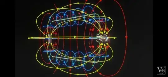

Veritasium video shows though that one shouldn't really think of this as some kind of "domino" effect for electrons, but rather as an EM wave propagating directly from the battery to the light bulb, as computing the Poynting vector reveals that the flow of energy is directed away from the battery and into the load (as shown in this screenshot taken from the video)red= electric field, blue= magnetic field, yellow=Poynting vector

However, in the video by Science Asylum there seems to be another perspective on the subject that I don't see exactly how it is equivalent to Veritasium's. Science Asylum shows that the electric field on the wire is not radial to the wire (as it seems is the case in Veritasium video, which I don't fully understand), but rather parallel to the wire (which kind of makes sense, as Ohm's law says that J=\sigma*E where \sigma is the electric conductivity, which means that the current density is in the same direction as the electric field...). But this means that when one computes the Poynting vector (as Science Asylum does in his video), it points AWAY from the wire and into the "field" around it. He then basically says (from my understanding) that the energy flows from the battery into the field around it and is then picked up by the light bulb and the wires directly from the field (doesn't say much about how "fast" is this process as in Veritasium video...).
In any case, what is the correct picture? I don't understand how both can be correct, given that they show electric fields pointing in different directions in the two videos... Is there something I'm missing here?

The Veratasium video concentrates on the battery and bulb. Those are the only two objects that exchange energy. It assumes there is no loss in the wires. The Science Asylum video assumes the wires have resistance and there are losses in them.
Science Asylum shows that the electric field on the wire is not radial to the wire (as it seems is the case in Veritasium video, which I don't fully understand), but rather parallel to the wire...
This is correct... in certain cases:
  • While current is changing (because the electric field needs to accelerate or decelerate the current)
  • While constant current is moving through a resistor (because the field needs to make up for the resistance losses.
In the first case, the accelerating charges need energy, so the energy has to be supplied by the battery (via the field). But if if this is a true A/C circuit, the charges are later decelerated. The field direction reverses and the energy is returned. The net energy flow over a cycle is zero.
In the second case, the resistance in the wires means that at a steady current, a field must exist inside the wire. The stronger the resistance, the stronger the losses and the stronger the axial field inside the conductor. Since there are losses, the energy must be replaced. This appears to be the contribution that the Science Asylum video is concentrating on. It treats both the wires and the bulb as energy consumers and the battery as an energy producer.
For many power delivery circuits the power loss in the wire is a small fraction of the power loss at the load (the bulb in both cases). It can be a reasonable assumption to ignore the loss in the wires. The Veritasium video, the Science Asylum video does not.
