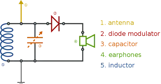

The circuit diagram of a simple radio receiver (see also here):
