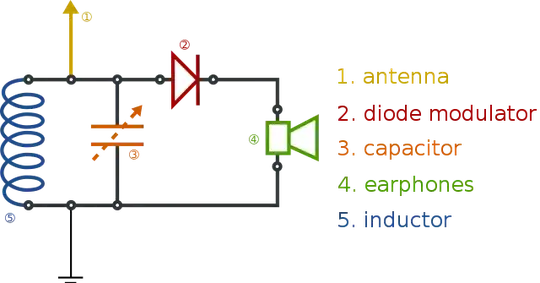

Photodetectors and radio receivers do not measure the same thing Photodetectors measure photon number - absorption of each photon corresponds to an event in a photodetector: an electron jumping from valence to conduction band in a photo-diode, a chemical change in a single molecule of a photographic film and likewise. In other words, the Hamiltonian describing the measurement is $H_{detector} =\lambda a^\dagger a$, where $a, a^\dagger$ are the photon annihilation and creation operators, whereas $a^\dagger a$ is the photon number operator.
Radio receiver measures something similar to photon phase (keeping in mind that the operator of photon phase is poorly defined in quantum mechanics) - the radio wave excites oscillations in the LC circuit. That is the measurement operator is more like $H_{receiver}=\lambda a^\dagger + \lambda^* a$.
Wave function collapse means projecting the wave function on a basis state of the Hamiltonian of the measurement device. The wave function of radio waves is not a photon number eigenstate, but a coherent state, in which the variance of the photon number is as big as the average number of photons. Measurement of coherent states by the operator $H_{receiver}$ is equivalent to shifting them. In other words, the photon coherent state collapses on a shifted coherent state. This might look very different from how one usually thinks of the wave function collapse, but it is wave function collapse in the very real sense.
Are photons absorbed by radio receiver?
We could go a step further and model the receiver as a quantum device (rather that treat it as an external observer, which is always implied to be classical). We could then describe the receiver interacting with photons by a Hamiltonian similar to Jaynes-Cummings model:
$$ H=\hbar\omega_0 a^\dagger a + \Delta b^\dagger b + \lambda(a^\dagger+ a)(b^\dagger + b). $$ If we were describing a photodetector, $b,b^\dagger$ would be the operators of a two-level system, and we would be aiming at calculating the occupancy of the excited state, $b^\dagger b$, whereas in case of radio receive these are bosonic operators describing the excitations in the LC circuit, and we are interested in the voltage or current given by $V, I \propto b \pm b^\dagger$.
The Hamiltonian above is in fact a Hamiltonian of two coupled oscillators - we could diagonalize it in terms of joint photon-circuit modes (polaritons), using polaron transformation. Absorption can then be described as projecting the coherent states of photons on these polariton states - the collapse becoming to look more real.
Finally, the detection of oscillating current/voltage is usually done using a non-linear element (like a diode), which essentially means measuring $(b^\dagger \pm b)^2\sim b^\dagger b$. That is, in the end the detection of radio waves is indeed reduced to a number operator (like in a photodetector), but well after the electromagnetic wave itself has "collapsed".
The circuit of a simple radio receiver:
