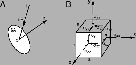

Concerning the symmetry: if the stress tensor were not symmetric there would be a net torque on the object and it would rotate. For an explanation see the image below. The components $\sigma_{ij}$ represent the shear forces on the $i$th face in the $j$th direction:
Stress tensor illustration
Since the stress tensor describes objects in equilibrium, the object doesn't rotate (that is, the net torque is zero -- this is the "conservation of angular momentum part) so $\sigma_{ij}=\sigma_{ji}$.
One important thing to remember is that there is the supposition that there is no force that acts on the bulk of the object that's capable of exert net torque (i.e., exchange angular momentum).
This idea changes when you think on something like the interplay between matter and electromagnetic field. Although you can adapt the image above to show that the full stress tensor of the whole system must be symmetric, it's not necessary the stress tensor of it's part should be symmetric too.
