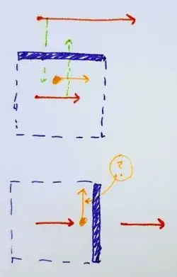

But what is the physical origin/interpretation of $\sigma_{xy}$, that is, a force acting in the $y$-direction on a surface with unit normal in the $x$-direction? Is it a reaction force to the tendency of the friction forces to rotate a fluid element?
An attempt to make it visual:
In the upper image, it seems reasonable that there is a momentum transfer (green arrow) across the thick blue surface, which results in a non-zero net rate of change of momentum/force (orange arrow) since the fluid velocities (red) are different on each side of the surface.
However, in the lower image I can't see the physical/microscopic origin of the (orange arrow) shear force (which must be there since the stress tensor is symmetric), since the velocities are the same and hence there is no net transfer of momentum across the (thick blue) surface.

Now, stress is the function of velocity gradient tensor as a whole and not only the symmetric part as you've written above. What you've written is correct only if we impose a constraint on the fluid element that the Moment of the shearing forces about the centre of the fluid element is zero. This condition causes the rotational velocity of the fluid element to become zero and therefore we can write the shear stress as the function of symmetric part only.
Assuming your case in which there is x-direction translation of the fluid element, let's say there is a no slip condition at the lower surface such that x dir. velocity is zero. Moment about the centre(M) $$M= \sigma_{yx}.(lb)h-\sigma_{xy}.(bh)l$$ where lb is area of the face on which sigma yx is acting and h is distance between the the opp. faces and respectively for sigma xy. So if M is zero we get $$ \sigma_{yx}.(lb)h=\sigma_{xy}.(bh)l$$
And therefore the $$\sigma_{xy}$$ is a result of maintaining rotational equilibrium.
