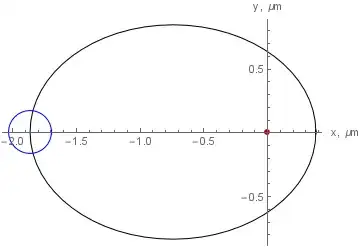

With these definitions, the orbit and the $3\sigma_0$ circle of the initial wave packet will look like:
orbit and initial wave packet outline

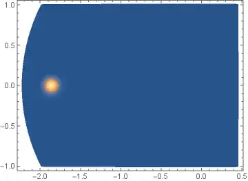

Here's how the wave packet evolution looks for the slice of $\theta=\frac\pi2$ for $t\in[0,0.95T]$ (a longer version can be downloaded from here, 50.3 MiB):
first orbital period of evolution at theta=pi/2
We can see that our estimations were a bit off: the wave packet doesn't appear to spread in the radial direction as much. But it's in fact good news.
