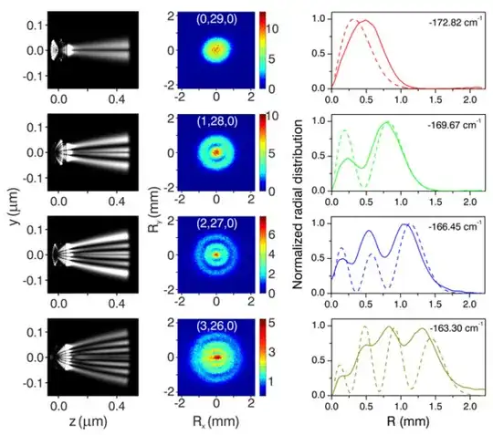

It is the difference between bound states and free particles. A bound state is a solution of a quantum mechanical equation, the wave function $Ψ$ a complex function and $Ψ^*Ψ$ is the probability of finding the electron about the nucleus at a specific (x,y,z,t). The electrons are in orbitals, not orbits, which is the naive "cloud" description. See Quantum microscope’ peers into the hydrogen atom.
What lies within the H atom? Experimental observation of the transverse nodal structure of four atomic hydrogen Stark states. The images in the middle show experimental measurements.
