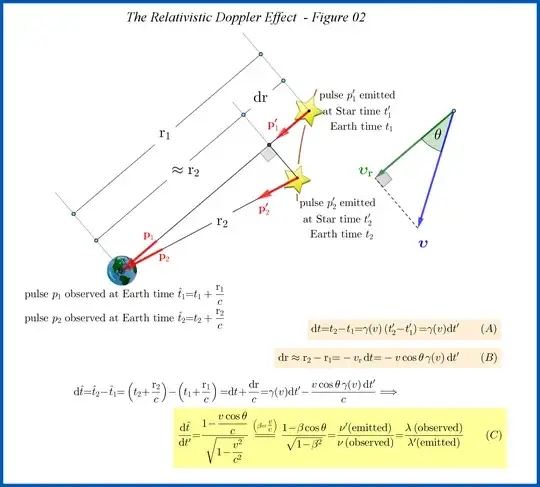

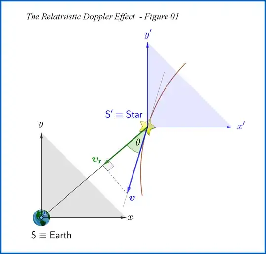

Hint :
Suppose two light pulses $p'_1$ and $p'_2$ are emitted successively from the Star towards the Earth at time moments $t'_1$ and $t'_2$, apart by an infinitesimal time interval $\mathrm{d}t'=t'_2\!-\!t'_1$. Time $t'$ is the time in the rest frame $\mathrm{S'}$ of the Star.
These two events happen in the rest frame $\mathrm{S}$ of the Earth at time moments $t_1$ and $t_2$, apart by the dilated infinitesimal time interval $\mathrm{d}t=t_2\!-\!t_1=\gamma\left(v\right)\mathrm{d}t'$. Time $t$ is the time in the rest frame $\mathrm{S}$ of the Earth.
Now, let the two light pulses arrive to Earth at Earth time moments $\hat{t}_{\!1}$ and $\hat{t}_{\!2}$, apart by an infinitesimal time interval $\mathrm{d}\hat{t}=\hat{t}_{\!2}\!-\!\hat{t}_{\!1}$. If the Star would be at rest relatively to Earth or its motion would be transverse (no radial motion : $v_\mathrm{r}=0$) then $\mathrm{d}\hat{t}=\mathrm{d}t$. But because of the radial motion of the Star relatively to Earth the 2nd pulse, which emitted later, has to run a larger distance than the 1rst pulse if the Star is moving away or has to run a smaller distance than the 1rst pulse if the Star is approaching. In the first case $\mathrm{d}\hat{t}>\mathrm{d}t$. In the second case, that shown in the Figure, $\mathrm{d}\hat{t}<\mathrm{d}t$.
So, if you could estimate the time interval $\mathrm{d}\hat{t}$ then you would solve the problem since the time intervals are inversely proportional to frequencies that is proportional to wavelengths : \begin{equation} \dfrac{\mathrm{d}\hat{t}}{\mathrm{d}t'}=\dfrac{\nu'}{\nu}=\dfrac{\lambda}{\lambda'}=\dfrac{\lambda \text{(observed)}}{\lambda'\text{(emitted)}} \end{equation}
Solution 1 (related to the Hint)
As shown in Figure-02 above
\begin{equation} \mathrm{d}t=t_2\!-\!t_1=\gamma(v)\left(t'_{\!2}\!-\!t'_{\!1}\right) =\gamma(v)\mathrm{d}t' \tag{1.01} \end{equation}
\begin{equation} \mathrm{dr}\approx \mathrm{r_2}-\mathrm{r_1}=-v_\mathrm{r}\,\mathrm{d}t=-v \cos\theta\, \gamma(v)\,\mathrm{d}t' \tag{1.02} \end{equation}
\begin{equation} \mathrm{d}\hat{t}=\hat{t}_2\!-\!\hat{t}_1=\left(t_2\!+\!\dfrac{ \mathrm{r}_2}{c}\right)\!-\!\left( t_1\!+\!\dfrac{ \mathrm{r}_1}{c} \right)=\mathrm{d}t\!+\!\dfrac{\mathrm{dr}}{c} =\gamma(v)\mathrm{d}t'\!-\!\dfrac{v \cos\theta\, \gamma(v)\,\mathrm{d}t' }{c} \Longrightarrow \nonumber \end{equation}
\begin{equation} \dfrac{\mathrm{d}\hat{t}}{\mathrm{d}t' } = \dfrac{1\!-\!\dfrac{v \cos\theta}{c}}{ \sqrt{1\!-\!\dfrac{v^2}{c^2}}} \stackrel{\left(\beta=\tfrac{v}{c}\right)}{=\!=\!=}\dfrac{1\!-\!\beta \cos\theta}{\sqrt{1\!-\!\beta^2}}=\dfrac{\nu' \text{(emitted)}}{\nu\:\text{(observed)}} =\dfrac{\lambda\:\text{(observed)}}{\lambda' \text{(emitted)}} \tag{1.03} \end{equation} QED.
