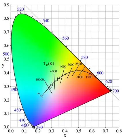

The physics of why the heated metal glows like a black body has already been thoroughly covered in the previous answers. However, in order to completely bridge the gap with the physiology of color perception (which has been alluded to in some answers), it is worth showing a picture of the Planckian locus:
Planckian locus in the CIE 1931 chromaticity diagram
Plot by PAR, from Wikimedia Commons
This is the set of all the colors a black body can have, plotted in a chromaticity diagram. It is computed by combining the black body emission formula with the color matching functions, which are a mathematical model of our color vision.
This graph clearly shows the path of a black body going hotter: red → orange → yellow → white → blue. Now, one may wonder by which coincidence it hits right into the white, rather than going slightly above (through the greens) or below (through the purples). That question, however, is backwards. The good question would be “Why have we chosen to name ‘white’ a color from the Planckian locus”. This is the question of the definition of white, and it is not straightforward.

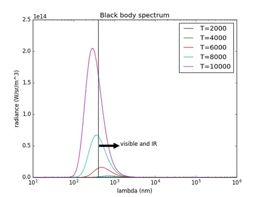

When metals (or any materials) get very hot, they emit "black body radiation". It's a funny name, because even "non black" bodies emit this thermal radiation. There may be some (small) deviations from the general law due to surface emissivity, but not so much that you would notice.
Black body radiation is not a single wavelength, it is a broad spectrum given by Planck's law. I gave a number of examples of this in this earlier answer. I will just reproduce one of the curves from there: enter image description here
This shows that the general shape of the emission curve is always the same - the only thing that changes is the position of the peak (which follows a 1/T law known as Wien's Displacement Law), and the area under the curve, which increases with the fourth power of the temperature (Stefan-Boltzmann law).
As I mentioned, in a "real" material there may be some "bumps" in the spectrum due to changes in emissivity with wavelength - but to the best of my knowledge this is not enough to stop the appearance of red-yellow-white as things get hotter. However, when things get very, very hot they might appear blue. However, at that temperature the intensity of light is so great (and with so much UV and shorter wavelength light) that I would highly recommend not trying to look at the source. But you can see this in the T=10000 curve above, which has much more blue than red light in it.

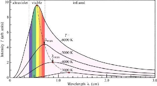

The black body emission spectrum at a number of temperature is shown below.
The colours shown on the graph illustrate the colours our eye would perceive if illuminate by the range of wavelengths spanned by a particular colour.
The brain interprets the information from the colour receptors (cones) and so you perceive a colour which sometimes can be "unexpected".
For example a combination of red and green light the eye perceives as yellow.
At a temperature of $3000 \, \rm K$ the vast majority of the visible light entering the eye is red and so the object is seen to be red.
As the temperature increases there is more red light but also orange light so the colour of the object changes and from a dull red it becomes a much brighter red.
At higher temperature there is a greater range of wavelength each stimulating the cones and because of this range the colour of the object is moving towards white not the individual colours which are emitted.
Raising the temperature even more which makes the proportions of the colours roughly equal the object makes the object look white.
An even higher temperature when it is very dangerous to look at the hot object directly because of the uv light which is also emitted, the white has a bluish ting.

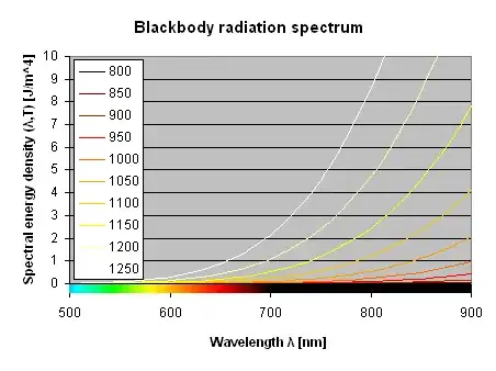

All wavelengths are included in what you call "white", thus all wavelengths are there.
The evolution you are describing is the evolution of the black body radiation as heat is increased.
You can see in the link that as temperature increases the curve moves to the left, to smaller wavelengths.
When the temperature of a blackbody radiator increases, the overall radiated energy increases and the peak of the radiation curve moves to shorter wavelengths.
Here is the left side of a black body radiator, which a hot metal is.
BBlow temp
Backbody radiation in the visible spectrum at 800, 850, 900, 950, 1000, 1050, 1100, 1150, 1200 and 1250 K.
As the temperature of the sample rises , the spectrum moves to the left, and more and more higher energy photons are released.
As heat increases , to the left, more and more photons at visible energies appear, first the red, then the yellow, then by the time temperature reaches green in the spectrum you already see "white" because that is the way color perception works in our eyes. From then on it is white for our perceptions.
red green blue
color mixing
The curves are almost flat at this level of detection and at temperature s where metal is incandescent , still the number of photons emitted is biased towards the infrared, there will always be more photons at a lower frequency than the next band of the spectrum thus blue cannot dominate over the "white" soup our eyes see.

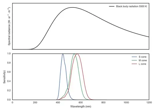

I made a figure to underscore what I think are the most crucial points to understand why black body radiation is never perceived as green:
  • The widths of and the separations between the spectral sensitivity curves of the human cone cells are much smaller than the width of the Planck curve.
  • The green cone (M cone) is the "middle" one, while the red and blue cones (L and S cones) are furthest displaced to one side each of the visible spectrum.
The result of this is that it is impossible to stimulate the M (green) cone with black body radiation without also stimulating either the L (red) or the S (blue) cone to a similar or larger degree.
The black body radiations that we perceive as most red and blue do not actually peak where the L and S cones peak in sensitivity. The L cone sensitivity peak around $570$ nm while the S cone sensitivity peak around $442$ nm. Using Wien's displacement law we find that the black body radiations for $\sim 5100$ K and $\sim 6550$ K would peak at these wavelengths. But in this figure (from Wikipedia), showing the perceived color of black body radiations for different temperatures, we can see that both of those temperatures would be perceived as more or less white.
The most red and blue black body radiations instead peak at much longer and shorter wavelengths. These are instead the Planck curves for which the slope is at its steepest between the peaks of the spectral sensitivity curves, producing the maximal contrast in stimulation between the different cone types.
