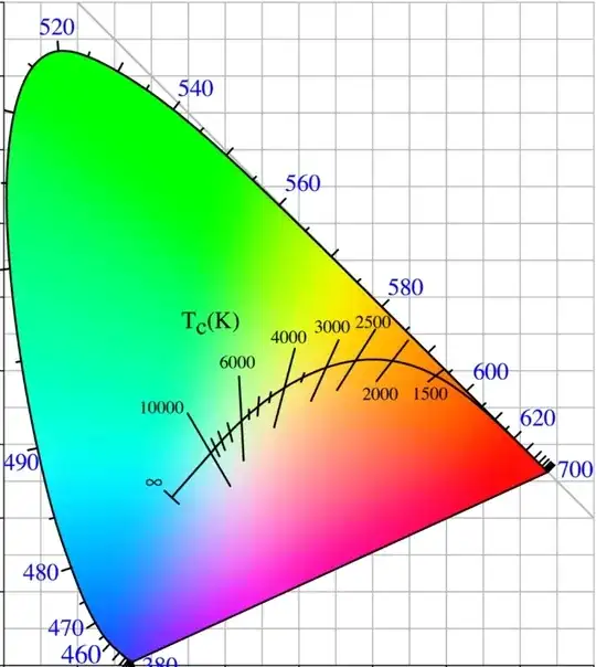

The other is human vision, and is best described by the CIE color space: enter image description here
The curved boundary with blue numbers (wavelength in nanometers) are the monochromatic colors. Any mixed color point inside figure can me made by an infinite number of binary mixture of 2 wavelengths which are given by drawing a straight line through the point that intersects the wavelength boundary at 2 points. Those 2 wavelengths are then mixed in contra-proportions to length of the chord joining the point. (This is for the average human eye).
The solid line with temperature in Kelvin is an average of the black body spectrum showing that it "turns on" in pure red, moves on to orange, yellow, white, and then finally blue for things like arc welders, lightning, and blackhole accretion disks.
