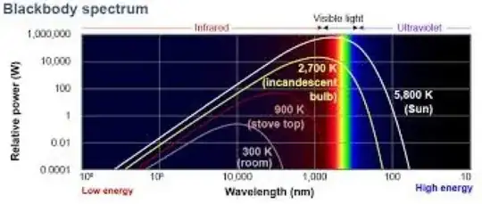

So although stars emit a range of wavelengths they do not all appear to be white because the colour of a star depends how much of each wavelength it emits which depends on the surface temperature of the star.
So Betelgeuseis a relatively cold star with a surface temperature of approximately $3,500\, \rm K$ and when observed from the Earth appaers to be red whereas Rigel with a surface temperature of approximately $11,000\, \rm K$ is seen as a bluish white star.

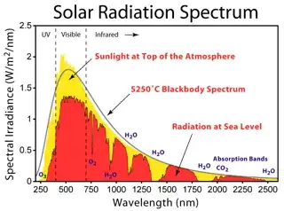

When star light is viewed from the Earth's surface the atmosphere complicates matters as does the absorption of certain wavelengths in the upper atmosphere of the stars however to a reasonable approximation one can say that the radiation (not just visible light but also infra-red, ultra-violet etc) emitted by a star is the same as that emitted by an idealised hot body called a black body.
The variation of light intensity as a function of wavelength is show below but not that in this graph the wavelength decreases as one moves to the right on the wavelength axis.

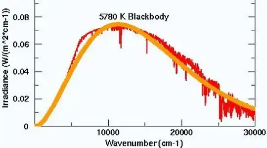

The "fit" for the the Sun's spectrum (red) compared to a black body at about $5,800 \, \rm K$ (orange) is shown below again wavelength is decreasing to the right where wave number is $\frac {1}{\rm wavelength}$.
Notice that the peak of the spectrum moves towards a smaller wavelength as the temperature increases.

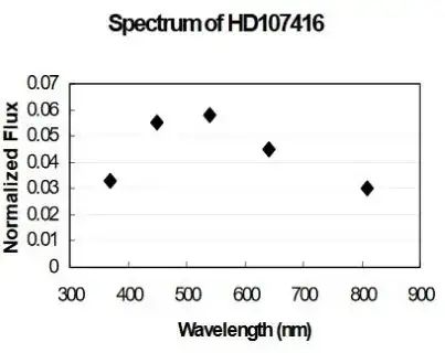

Here is one for you to try with a linear wavelength scale which comes Page 55 of NASA Space Math V and the answer is on Page 56.
