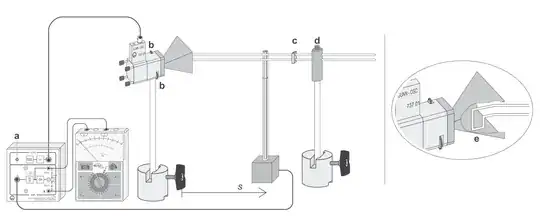

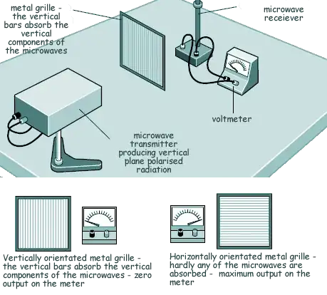

It depends on what you mean by "directly observed charges oscillating" and whether the formation of a standing wave is essential.
Using microwaves to demonstrate that they can be polarised you can infer the direction of oscillation of the electric vector in an electromagnetic wave.
If there is a horn receiver as well as a horn transmitter then just rotating one relative to the other produce a variation the amplitude of the received signal to show that the transmitted microwaves are polarised.
This can lead on to demonstrating polarisation of light using a Polaroid which on a molecular scale has crystals orientated in parallel which can form a conducting path just like the rods for microwaves.
If you do need the condition that the demonstration has to be for standing waves then a pair of Letcher lines might be of use?
Microwaves (or UHF waves) from a transmitter $b$ are guided along a pair of parallel uninsulated conducting rods with a spacing less than that of the wavelength of the microwaves and if shorted ($c$ in the diagram) produce a standing wave pattern which can be investigated by either observing the voltage nodes and antinodes or current nodes and antinodes.
Leybold produce an excellent leaflet describing the sort of experiments which can be performed with such an apparatus.
