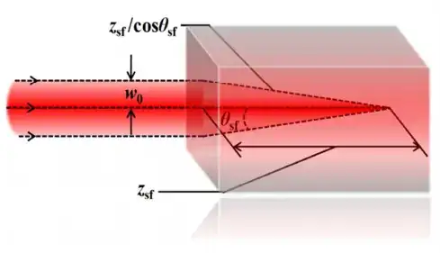

However, if you try to push onward with a bigger laser amplifier and more and more power, you are basically destined sooner or later to hit a brick wall, rather brusquely, in the form of catastrophic self-focusing. This is a consequence of yet another nonlinear effect, the Kerr effect, happening inside the laser medium itself. At face value, the Kerr effect looks harmless enough: basically, it says that if the intensity is high enough, the refractive index of the material will rise slightly, in proportion to the intensity: $$ n(I) = n_0 + n_2\: I. $$ So, what's the big deal? In short, if you have a laser beam propagating through such a medium, then
  • the intensity of the light will be higher in the center, which means that the refractive index will be higher in the center.
  • In other words, the material's optical properties will look like those of a convex lens, and it will tend to focus the beam.
  • This will tend to make the beam sharper, which will increase the intensity at the center, which will raise the refractive index at the center even higher...
  • ... which will then focus the beam even more tightly, leading to higher and higher intensities.
This makes up a positive feedback loop, and if the initial intensity is high enough, the medium is long enough, and there isn't enough initial diffraction to counteract it, then it will spiral out of control and cause catastrophic laser-induced damage in the very medium that you're trying to use to amplify that laser beam. (Moreover, it is quite common, particularly in air, that the laser will diffract on the damaged spot and then re-self-focus a bit further down the line, a phenomenon known as laser filamentation. If you get things just right wrong, this can propagate a failure in the gain medium up to the destruction of an entire beamline.)
Image source

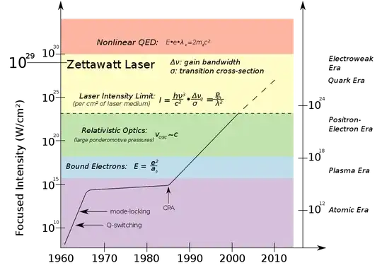

This sounds like a funky mechanism, but it was a huge roadblock for a very long time. If you plot the highest laser intensity available at different times since the invention of the laser, it climbs quickly up during the sixties, and then it hits a wall and stays put for some ten to fifteen years:
Image source
This represents the barrier of Kerr-lens self-focusing, and at the time the only way to overcome it was to build a laser which was physically bigger, to dilute the intensity over more gain medium to try to prevent the problem. Until, that is, Chirped Pulse Amplification came around to solve the problem.

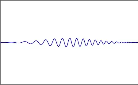

  2. You then stretch it in time, by introducing chirp into the signal: that is, you use some sort of dispersive element, like a prism or a diffraction grating, which decomposes the pulse into all of its constituent colors and sends the longer wavelengths first and the shorter wavelengths last. This will naturally reduce the intensity of the pulse.
    Mathematica graphics
    (Why "chirp"? because the upward (or downward) sweep of frequencies over the pulse is precisely what gives bird chirps their characteristic sound.)

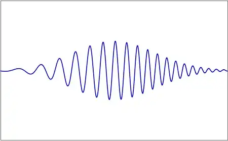

  4. Finally, you pass your pulse through a reversed set of gratings which will undo the relative delay between the longer- and shorter-wavelengths of your pulse, putting them all together into a single pulse of the same shape and length as your original pulse...
    ... but at the much higher amplified power, and at intensities which would be impossible to achieve safely using direct amplification of the pulse.
