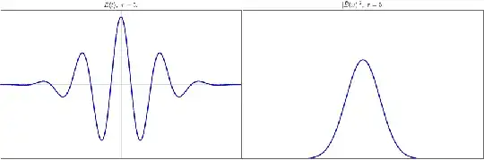

It is much easier if you put this in an explicit mathematical form, with a gaussian envelope: in the time domain, you have the envelope multiplying some carrier oscillation, with some carrier-envelope phase $\varphi_\mathrm{CE}$, $$ E(t) = E_0 e^{-\frac12 t^2/\tau^2} \cos(\omega_0 t+\varphi_\mathrm{CE}) $$ and then it is trivial to Fourier-transform it to the frequency domain, where you get two gaussians centered at $\pm \omega_0$: $$ \tilde E(\omega) = \frac{1}{2} \tau E_0\left[ e^{+i \varphi_\mathrm{CE} } e^{-\frac{1}{2} \tau ^2 (\omega +\omega_0)^2} + e^{-i \varphi_\mathrm{CE} } e^{-\frac{1}{2} \tau ^2 (\omega -\omega_0)^2} \right] . $$ So, how does this look like? Well, here is one sample, with the carrier-envelope phase set to zero, of how the spectrum broadens as the time-domain pulse length shrinks,
but the thing to do is to play with how the different parameters (and particularly the carrier-envelope phase $\varphi_\mathrm{CE}$) affect the shape of both the time-domain pulse and its power spectrum. As you can see, when the pulse length is shorter than the carrier's period, the role of the carrier loses a good deal of its significance, but it can still be an important part of the description of the pulse.

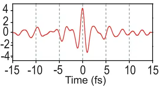

In the real world, though, pulses are much messier than just the width and the carrier-envelope phase, and if you really are in the few-cycle regime with real-world pulses then you need to worry about much more than just the pulse width, and the whole shape of the pulse comes into play ─ often involving substantial ringing in pre- and post-pulse oscillations. When you actually get down to few-femtosecond pulses, the state of the art of how short and clean (and well-characterized) you can get the pulses looks something like this:
(from Synthesized Light Transients, A. Wirth et al., Science 334, 195 (2011); this is real measured-then-inferred data of the pulse shape, as described here).
