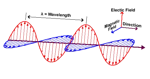

Light is considered as combination of electric and magnetic fields. So does a charged particle experience electric force in the presence of light?

Technically yes, but since the electric field in an optical wave oscillate at extremely high frequencies (hundreds of THz), the inertia of the particle prevents it from following this motion. The field switches directions, before the particle can move appreciably in the direction of the field.
The magnetic field does not exert a force on a charged particle, only when it is moving.
