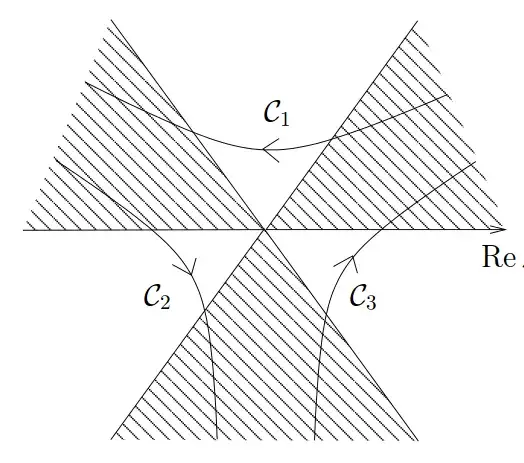

V) There are 2 critical points:
$$\begin{align} p_{\sigma} ~=~& \sigma~ {\rm sgn}(\alpha)~P , \cr S_{\sigma}~=~& \frac{2\sigma P^3 }{3|\alpha|} , \cr S^{\prime\prime}_{\sigma}~=~& -2\sigma |\alpha| P , \cr \sigma ~\in~&\{\pm 1\}.\end{align} \tag{12}$$
The steepest descent contribution from each critical point comes from a Gaussian integral:
$$\begin{align} I_{\sigma}~=~& \sqrt{\frac{|\alpha|}{\pi\hbar}} \sqrt{\frac{2\pi i\hbar}{S^{\prime\prime}_{\sigma} } } \exp\left(\frac{i S_{\sigma}}{\hbar}\right)\cr ~=~&\frac{1}{\sqrt{P}} \exp\left(\frac{2i\sigma P^3}{3\hbar |\alpha|} -\frac{i\sigma \pi}{4}\right)\cr ~=~& \frac{1}{\sqrt{|P|}} \exp\left(\frac{2i\sigma |P|^3e^{3i\theta}}{3\hbar |\alpha|} -i\left(\frac{\sigma \pi}{4}+\frac{\theta}{2}\right)\right) \end{align} \tag{13} $$
with angular steepest descent direction $-\frac{\sigma \pi}{4}-\frac{\theta}{2}$.
$\uparrow$ Fig. 1. The complex $p$-plane with 3 possible integration contours ${\cal C}_1$, ${\cal C}_2$, ${\cal C}_3$ for $\alpha<0$. The shaded regions denote exponentially decaying sectors. (If $\alpha>0$, it is opposite.) Since the integrand is an entire function in $p$, the $p$-integral only depend on the monodromy of the contour. (Figure taken from Ref. [W].)
VI) Now let us return to L&L's example with $\alpha<0$.
Classically forbidden region $x>x_0$: Then $P=\pm i|P|$, with $\theta=\pm \frac{\pi}{2}$, where $\pm$ corresponds to two different possible sign choices. The contour along the real $p$-axis is reproduced by the steepest descent contour corresponding to the critical point $p_{\mp 1}$:
$$\begin{align} \psi_{<}(x)~\sim~& I_{\mp 1}\cr ~=~& \frac{1}{\sqrt{|P|}} \exp\left(-\frac{2|P|^3}{3\hbar |\alpha|} \right). \end{align} \tag{14} $$
Classically allowed region $x<x_0$: Then $P=|P|>0$ with $\theta=0$. The contour along the real $p$-axis is reproduced by the sum of both steepest descent contours:
$$\begin{align} \psi_{>}(x)~\sim~& \sum_{\sigma\in\{\pm 1\}}I_{\sigma}\cr ~=~& \frac{1}{\sqrt{|P|}}\sum_{\sigma\in\{\pm 1\}} \exp\left(i\sigma\left(\frac{2|P|^3}{3\hbar |\alpha|} -\frac{ \pi}{4}\right)\right)\cr ~=~&\frac{2}{\sqrt{|P|}} \cos\left(\frac{2|P|^3}{3\hbar |\alpha|} -\frac{\pi}{4} \right)\cr ~=~& \frac{2}{\sqrt{|P|}} \sin\left(\frac{2|P|^3}{3\hbar |\alpha|} +\frac{\pi}{4} \right).\end{align} \tag{15} $$
By comparing eqs. (14) & (15), we have derived a connection formula. In detail, by comparing the contributions to the critical points $p_{\mp 1}$, we deduce L&L's eqs. (47.4c) and (47.4b), respectively. So the two methods agree.
