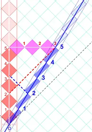

The key figure (using $v=(3/5)c$) is
robphy-RRGP-diamonds
Once the light-clock diamond size is established (using the Bondi k-calculus in the above), the spacelike-diagonal of the light-clock diamond determines the reflection events on the mirror worldlines of the longitudinal light-clock. So, draw through those events parallels to the timelike diagonal (the observer's worldline). This shows length-contraction as viewed in the lab frame. (The construction can be shown to be symmetric between the observers.)

The key idea is that the diamond size is determined by the Principle of Relativity. (The diamond shape is determined by the Speed of Light Principle and the velocity of the observer.) The two observers perform the same experiment and should expect the same results:
2 seconds after they meet, send a light signal to the other.
Assuming absolute time and absolute space fails to satisfy the principle, but the third configuration works.
Using $v=(3/5)c$... and assuming the Speed of Light Principle.. we have the shape of Bob's diamonds... but what is the correct size?
Assuming absolute time (so that the heights of the diamonds are equal),
Alice (red) receives Bob's signal at 3.2, whereas Bob (blue) receives Alice's at 5.
Bob's ticks need to be scaled up from this size. This hints that there is time-dilation... but by how much?

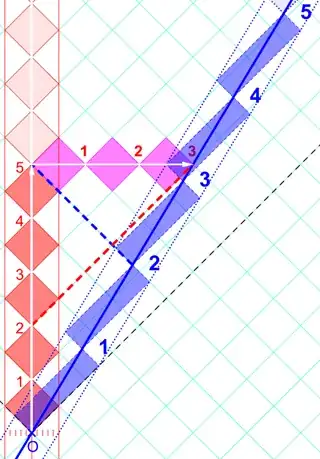

Assuming absolute space (so the lengths of the cross-sections of the light-clocks are equal),
Alice (red) receives Bob's signal at 5, whereas Bob (blue) receives Alice's at 3.2.
Bob's ticks need to be scaled down from this size. This hints that there is length-contraction... but by how much?
