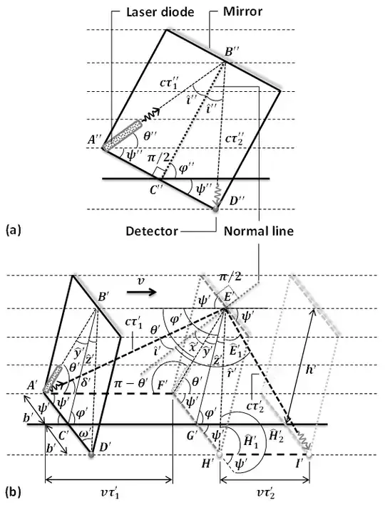

No, it's the same. The time dilation formula is independent of the direction of motion or the light clock inclination. I am in the middle of my second book in which a section entitled Einstein's Oblique Light Clock is somehow devoted to your question. However, I used this oblique light clock to derive the relativistic reflection law. In other words, when the oblique light clock moves, the incident $(\hat{i}')$ and reflected $(\hat{r}')$ angles are no longer equal. The calculations are slightly complicated, however, I provide you with the relevant figure that may help you to derive the right equations. Remember that you need to prove that:
$$\frac{\tau''_1+\tau''_2}{\tau'_1+\tau'_2}=\sqrt{1-\frac{v^2}{c^2}}$$
For simplicity, you can either assume $\theta''=\phi''$ or $\psi''=0$.
