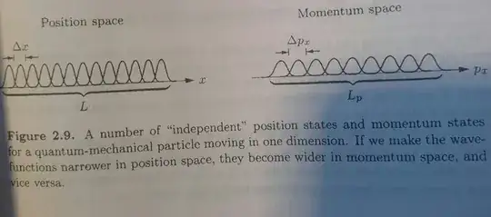

The problem is set in momentum space, and deals with the multiplicity of a monotonic ideal gas. From my textbook:
The number of independent wavefunctions is finite, if the total available position space and momentum space are limited.
L/$\Delta x$ is the number of distinct position states and L$_p$/$\Delta p$ is the number of distinct momentum states, (in a 1 dimensional system). The total number of distinct states is the product:
$\frac {L} {\Delta (x)}$$\frac {L_p} {\Delta (p )}$ =$\frac {LL_p} {h}$
Using the uncertainty principle.
My question is, what does this physically represent?

Ok, so here is a heuristic (many things will be very informal, the emphasis will be on intuition) justification to your equation:
Divide your system (particle in a periodic box of width L) to $N_x$ periodic boxes, so that new boxes have width $L/N_x$. There are infinite states in these small boxes as well, but their energy (and momentum) separation will be much larger due to their localization. The wave length of a wave fitting to a such of a box is now obviously $L/(N_x n)$, where n is an integer. The momentum is proportional to inverse wave length i.e. $N_x n /L$, and therefore, the separation of momentum is roughly $N_x/L$.
One notes immediately, that the more finely one defines the position grid, the further apart the expectation values of momenta are of these localized states. So, if we now say that we will impose a cutoff to momentum at $L_p$, roughly $Lp / (N_x / L)$ states will fit. So in total, one get's a total number of states, $N_x N_p = N_x \cdot Lp / (N_x / L) = L L_p$. And then there some factors of $\hbar$ and $2\pi$'s because I skipped the details.
More formally, one can take the original free wave solutions $\Psi_n({\bf r})$ of the box, and form new linear combinations $\Psi_{px} = \sum c_{pxn} \Psi_n({\bf r})$ which are localized to certain areas and have different momenta. They will never be exactly localized to a particular length $L/N_x$, but nevertheless, similar arguments can be followed through. The Heisenberg uncertainty principle does not care about the details, but it will always hold and give a limit to the maximum knowledge of momentum and position of the particle.
