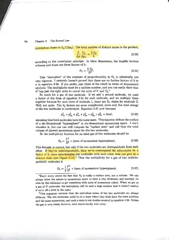

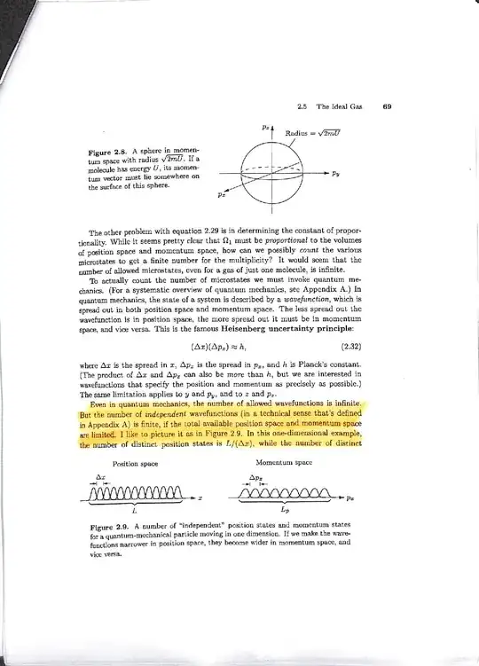

I'm reading Daniel Schroeder's An Introduction to Thermal Physics. Please see the below pictures for the text from which I have questions:
  1. On pp. 69, I don't get the underlined text. What does he mean by there being a finite number of independent wave functions if both position and momentum space are limited. For, say, a particle in a box, all the wave functions of the TISE are sinusoidal of the form - $\sin \Bigg ( \displaystyle \frac{2 \pi n x}{\displaystyle L} \Bigg )$. They're all orthogonal but the set of all such functions is countably infinite, no?
  2. More Importantly I am not able to understand his description of the number of distinct position states and how he uses it to calculate the multiplicity of a single monoatomic ideal gas in a container at fixed energy and volume. I don't see the rationale/reasoning behind. This derivation proceeds to the first few lines of pp. 70 as well.
Please ignore the highlighted text toward the end of pp. 70.
Thanks.

Concerning (1): The states you wrote have energy $\frac{\hbar^2}{2m}(\frac{2\pi n}{L})^2$ and in this case there is indeed infinitely many linearly independent wavefunctions.
In the book, the author begins by considering a single gas atom of fixed energy $U$ inside a box. Then he wants to count the number of linearly independent wavefunctions at this particular energy. This corresponds to a sphere in momentum space: $p_x^2+p_y^2+p_z^2=p^2$, and the number of such linearly independent wavefunctions is finite.
I think he stresses that you need independence to get a finite number, because given two energy eigenstates $|\phi\rangle$,$|\psi\rangle$, one can always take "silly" linear combinations:
$\alpha |\phi\rangle+(1-\alpha)|\psi\rangle$.
Hope this helps.
Edit: about (2):
This is traditionally done for $N$ particles but let me give an informal sketch:
Using count_to_10's notation: $E_=(n_x^2+n_y^2+n_z^2) h^2/8mL^2$. We now want to count how many states have energy smaller than $\bar{E}$.
First of all some notation: let $\Phi(\bar{E})$ denote the number of states with energy $\leq \bar{E}$ and $\omega(\bar{E})$ denotes the number of states with energy in the range $[\bar{E},\bar{E}+\delta E]$.
Looking at the formula for the energy: $(n_x^2+n_y^2+n_z^2)=8mL^2 E / h^2$. This is precisely stating that the vector $(n_x,n_y,n_z)$ has fixed length (squared norm). Hence states with energy smaller than $\bar{E}$ are given by points in $n$ space inside the sphere of radius $(8mL^2 E / h^2)^{1/2}$. The total number of such points may be approximated by the volume of the sphere:
$\Phi(\bar{E})=\frac{1}{8}\frac{4}{3}(\frac{8mL^2\bar{E}}{h^2})^{\frac{3}{2}}$.
The $1/8$ is due to the fact that we only consider positive $n$'s, hence only one octant.
Now that we know the number of state with energy $\leq \bar{E}$, we may get the number of states with energy in $[\bar{E},\bar{E}+\delta E]$ by taking the derivative wrt. $\bar{E}$:
$\omega(\bar{E})=\frac{1}{4} L^3 (\frac{8m}{h^2})^{3/2} E^{\frac{1}{2}} \delta E$.
Here you see the "position volume" given by $L^3$ and the rest may be thought as coming from the volume spanned by allowed momentas. Anyway in think the author wrote this formula as a handwaving argument and will prove the exact result later in the book.
P.s.: the above trick may be understood as follows:
$\omega(E)=\Phi(E+\delta E)- \phi(E)= \frac{\Phi(E+\delta E)-\Phi(E)}{\delta E} \delta E \approx \frac{d\Phi}{dE}\delta E$.
