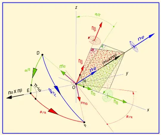

1. Pauli matrices-Rotations-Special Unitary matrices $\:\mathrm{SU}(2)\:$
Any vector in $\mathbb{R}^3$ can be represented by a $2\times2$ hermitian traceless matrix and vice versa. So, there exists a bijection (one-to-one and onto correspondence) between $\mathbb{R}^3$ and the space of $2\times2$ hermitian traceless matrices, let it be $\mathbb{H}$ : \begin{equation} \mathbf{x}=(x_1,x_2,x_3)\in \mathbb{R}^3\;\longleftrightarrow \; X= \begin{bmatrix} & x_3 & x_1-ix_2 \\ & x_1+ix_2 & -x_3 \end{bmatrix} \in \mathbb{H} \tag{001} \end{equation} From the usual basis of $\mathbb{R}^3$ \begin{equation} \mathbf{e}_{1}=\left(1,0,0\right),\quad \mathbf{e}_{2}=\left(0,1,0\right),\quad \mathbf{e}_{3}=\left(0,0,1\right) \tag{002} \end{equation} we construct a basis for $\mathbb{H}$ \begin{eqnarray} \mathbf{e}_1 &=&(1,0,0)\qquad \longleftrightarrow \qquad \sigma_1= \begin{bmatrix} &0&1&\\ &1&0& \end{bmatrix} \tag{003a}\\ \mathbf{e}_2 &=&(0,1,0)\qquad \longleftrightarrow \qquad \sigma_2= \begin{bmatrix} &0&-i\\ &i&0 \end{bmatrix} \tag{003b}\\ \mathbf{e}_3 &=&(0,0,1)\qquad \longleftrightarrow \qquad \sigma_3= \begin{bmatrix} &1&0\\ &0&-1 \end{bmatrix} \tag{003c} \end{eqnarray} where $\:\boldsymbol{\sigma}\equiv(\sigma_{1},\sigma_{2},\sigma_{3})\:$ the Pauli matrices(1), essentially the components of the spin $\:s=1/2\:$ angular momentum by a factor $\:1/2\:$ \begin{equation} S_1=\dfrac{1}{2}\sigma_{1}\;, \quad S_2=\dfrac{1}{2}\sigma_{2}\;, \quad S_3=\dfrac{1}{2}\sigma_{3}, \quad \text{or} \quad \mathbf{S}=\dfrac{1}{2}\boldsymbol{\sigma} \tag{004} \end{equation} Suppose now that the vector $\:\mathbf{x}=(x_1,x_2,x_3)\:$ is rotated around an axis with unit vector $\:\mathbf{n}=(n_1,n_2,n_3)$ through an angle $\theta$(2) \begin{equation} \mathbf{x}^{\prime}= \cos\theta \;\mathbf{x}+(1-\cos\theta)\;(\mathbf{n}\boldsymbol{\cdot}\mathbf{x})\;\mathbf{n}+\sin\theta\;(\mathbf{n}\boldsymbol{\times}\mathbf{x}) \tag{005} \end{equation} and let to the vectors $\:\mathbf{x},\mathbf{x}^{\prime}\:$ correspond the matrices \begin{eqnarray} X & \equiv & \mathbf{x}\boldsymbol{\cdot} \boldsymbol{\sigma} = x_1\sigma_1+x_2\sigma_2+x_3\sigma_3= \begin{bmatrix} x_3&x_1-ix_2\\ x_1+ix_2&-x_3 \end{bmatrix} \tag{006a}\\ X{'} & \equiv & \mathbf{x}{'}\boldsymbol{\cdot} \boldsymbol{\sigma} = x_1^{'}\sigma_1+x_2^{'}\sigma_2+x_3^{'}\sigma_3= \begin{bmatrix} x^{'}_3&x^{'}_1-ix^{'}_2\\ x^{'}_1+ix^{'}_2&-x^{'}_3 \end{bmatrix} \tag{006b} \end{eqnarray}
Taking the inner product of equation (005) with $\boldsymbol{\sigma}$ \begin{equation} (\mathbf{x}{'}\boldsymbol{\cdot}\boldsymbol{\sigma}) = \cos\theta(\mathbf{x}\boldsymbol{\cdot}\boldsymbol{\sigma})+(1-\cos\theta)(\mathbf{n}\boldsymbol{\cdot}\mathbf{x})(\mathbf{n}\boldsymbol{\cdot}\boldsymbol{\sigma})+\sin\theta[(\mathbf{n}\boldsymbol{\times}\mathbf{x})\boldsymbol{\cdot}\boldsymbol{\sigma})] \tag{007} \end{equation}
we have \begin{equation} X{'} = \cos\theta \;X+(1-\cos\theta)(\mathbf{n}\boldsymbol{\cdot}\mathbf{x})N+\sin\theta[(\mathbf{n}\boldsymbol{\times}\mathbf{x})\boldsymbol{\cdot}\boldsymbol{\sigma})] \tag{008} \end{equation} where \begin{equation} N \equiv \mathbf{n}\boldsymbol{\cdot}\boldsymbol{\sigma}= \begin{bmatrix} n_3&n_1-in_2\\ n_1+in_2&-n_3 \end{bmatrix} \tag{009} \end{equation}
After a not so easy elaboration(3) equation (008) turns to be \begin{equation} X{'}=\left[I\cos\frac{\theta}{2}-i(\mathbf{n} \boldsymbol{\cdot} \boldsymbol{\sigma})\sin\frac{\theta}{2} \right]\;X\;\left[I\cos\frac{\theta}{2}+i(\mathbf{n}\boldsymbol{\cdot}\boldsymbol{\sigma})\sin\frac{\theta}{2} \right] \tag{010} \end{equation} and in compact form \begin{equation} X{'}=U\;X\;U^{\boldsymbol{*}} \tag{011} \end{equation} where
\begin{equation} U\equiv \cos\frac{\theta}{2}-i(\mathbf{n} \boldsymbol{\cdot} \boldsymbol{\sigma})\sin\frac{\theta}{2} \tag{012} \end{equation} with hermitian conjugate \begin{equation} U^{\boldsymbol{*}}=I\cos\frac{\theta}{2}+i(\mathbf{n} \boldsymbol{\cdot} \boldsymbol{\sigma})\sin\frac{\theta}{2} \tag{013} \end{equation} We choose the $2 \times 2$ complex matrix $U$ to represent the rotation (005).
Now, because of the identity \begin{equation} (\mathbf{n} \boldsymbol{\cdot} \boldsymbol{\sigma})^2=\left\|\mathbf{n}\right\|^{2} I=I \tag{014} \end{equation} we have \begin{equation} UU^{\boldsymbol{*}}=I=U^{\boldsymbol{*}}U \tag{015} \end{equation} Operators with this property are called unitary operators, symbol $\:\mathrm{U}(2)\:$ for our case, and in general $\:\mathrm{U}(n)\:$ for $n \times n$ complex matrices. Any unitary matrix $\:U\:$ has as determinant a unit complex number $\:\det(U)=e^{i\phi}, \phi \in \mathbb{R}\:$.
An explicit expression of $U$ in (012) is \begin{equation} U= \begin{bmatrix} \cos\frac{\theta}{2}-i\sin\frac{\theta}{2}n_{3} & & -\sin\frac{\theta}{2}\left( n_{2}+in_{1}\right) \\ \sin\frac{\theta}{2}\left( n_{2}-in_{1}\right) & & \cos\frac{\theta}{2}+i\sin\frac{\theta}{2}n_{3} \end{bmatrix} = \begin{bmatrix} \alpha & \beta \\ -\beta^{\boldsymbol{*}} & \alpha^{\boldsymbol{*}} \end{bmatrix} \tag{016} \end{equation}
where here \begin{equation} \alpha =\cos\frac{\theta}{2}-i\sin\frac{\theta}{2}n_{3} \qquad \beta=-\sin\frac{\theta}{2}\left( n_{2}+in_{1}\right) \tag{017} \end{equation} but more generally $\left(\alpha,\beta \right)$ any pair of complex numbers satisfying the condition \begin{equation} \alpha \alpha^{\boldsymbol{*}}+\beta\beta^{\boldsymbol{*}}=\left\|\alpha\right\|^2 + \left\|\beta\right\|^2=1 \tag{018} \end{equation} So, the unitary matrix $\:U\:$ in (012) has as determinant the real positive unit $\:\det(U)=+1\:$. Unitary matrices with $\:\det(U)=+1\:$ are called special unitary and the set symbol is $\:\mathrm{SU}(n)\:$ in general. So for the unitary matrix $\:U\:$ in (012) we have $\:U \in \mathrm{SU}(2)\:$.
2. Quaternions-Rotations
The unitary matrix representation (016) is simplified if we define the following quantities \begin{align} \mathbf{1} & \equiv I = \begin{bmatrix} 1&0\\ 0&1 \end{bmatrix} \tag{019a}\\ \mathbf{i} & \equiv -i\sigma_{1} = \begin{bmatrix} 0&-i\\ -i&0 \end{bmatrix} \tag{019b}\\ \mathbf{j} & \equiv -i\sigma_{2} = \begin{bmatrix} 0&-1\\ 1&0 \end{bmatrix} \tag{019c}\\ \mathbf{k} & \equiv -i\sigma_{3} = \begin{bmatrix} -i&0\\ 0&i \end{bmatrix} \tag{019d} \end{align}
with properties \begin{equation} \mathbf{i}^{2}=\mathbf{j}^{2}=\mathbf{k}^{2}=-\mathbf{1} \tag{020} \end{equation} \begin{equation} \mathbf{i} \cdot \mathbf{j}=\mathbf{k}=-\mathbf{j}\cdot \mathbf{i} \quad , \quad \mathbf{j} \cdot \mathbf{k}=\mathbf{i}=-\mathbf{k}\cdot \mathbf{j} \quad , \quad \mathbf{k} \cdot \mathbf{i}=\mathbf{j}=-\mathbf{i}\cdot \mathbf{k} \tag{021} \end{equation} \begin{equation} \mathbf{i} \cdot \mathbf{j}\cdot \mathbf{k}= -\mathbf{1} \tag{022} \end{equation}
Then \begin{equation} U= \left(\cos\frac{\theta}{2}\right)\mathbf{1}+\left(n_{1}\sin\frac{\theta}{2}\right)\mathbf{i}+\left(n_{2}\sin\frac{\theta}{2}\right)\mathbf{j}+\left(n_{3}\sin\frac{\theta}{2}\right)\mathbf{k} \tag{023} \end{equation} and setting \begin{equation} \cos\frac{\theta}{2}\equiv q_{0}\quad , \quad n_{1}\sin\frac{\theta}{2} \equiv q_{1} \quad , \quad n_{2}\sin\frac{\theta}{2} \equiv q_{2} \quad , \quad n_{3}\sin\frac{\theta}{3} \equiv q_{3} \tag{024} \end{equation} we have \begin{equation} U= q_{0}\mathbf{1}+ q_{1}\mathbf{i}+q_{2}\mathbf{j}+q_{3}\mathbf{k} \quad , \quad q_{\kappa}\in \mathbb{R}\quad , \quad q_{0}^{2}+q_{1}^{2}+q_{2}^{2}+q_{3}^{2}=1 \tag{025} \end{equation} Inversely, an expression $ U $ defined by (025) represents a rotation with parameters
$ \mathbf{n},\theta $ determined by equations (024).
If in equation (012) we replace $\theta$ by $-\theta$ or exclusively $\mathbf{n}$ by $-\mathbf{n}$, then we have the inverse rotation \begin{equation} U^{-1}= I\cos\frac{\theta}{2}+i(\mathbf{n} \boldsymbol{\cdot}\boldsymbol{\sigma})\sin\frac{\theta}{2}\equiv U^{\boldsymbol{*}} \tag{026} \end{equation} and so \begin{equation} U^{-1}=U^{\boldsymbol{*}}= q_{0}\mathbf{1}-q_{1}\mathbf{i}-q_{2}\mathbf{j}-q_{3}\mathbf{k} \quad , \quad q_{\kappa}\in \mathbb{R}\quad , \quad q_{0}^{2}+q_{1}^{2}+q_{2}^{2}+q_{3}^{2}=1 \tag{027} \end{equation} Ignoring the condition \begin{equation} q_{0}^{2}+q_{1}^{2}+q_{2}^{2}+q_{3}^{2}=1 \tag{028} \end{equation} we define the so called quaternions by \begin{equation} \boldsymbol{\mathsf{Q}}= q_{0}\mathbf{1}+ q_{1}\mathbf{i}+q_{2}\mathbf{j}+q_{3}\mathbf{k} \quad , \quad q_{\kappa}\in \mathbb{R} \tag{029} \end{equation} In analogy to the properties of complex numbers \begin{equation} z=a+ib \quad , \quad z^{\boldsymbol{*}}=\text{conjugate of } z =a-ib \quad , \quad \Vert z \Vert ^{2}=zz^{\boldsymbol{*}}=a^{2}+b^{2} \tag{030} \end{equation}
we define the conjugate of quaternion $\boldsymbol{\mathsf{Q}}$ to be \begin{equation} \boldsymbol{\mathsf{Q}}^{\boldsymbol{*}}= q_{0}\mathbf{1}- q_{1}\mathbf{i}-q_{2}\mathbf{j}-q_{3}\mathbf{k} \tag{031} \end{equation} but since, making use of properties (020) and (021), the expression $\boldsymbol{\mathsf{Q}}\boldsymbol{\mathsf{Q}}^{\boldsymbol{*}}$ in not a number but a scalar multiple of the identity quaternion \begin{equation} \boldsymbol{\mathsf{Q}}\boldsymbol{\mathsf{Q}}^{\boldsymbol{*}}= \left( q_{0}\mathbf{1}+q_{1}\mathbf{i}+q_{2}\mathbf{j}+q_{3}\mathbf{k}\right) \left( q_{0}\mathbf{1}- q_{1}\mathbf{i}-q_{2}\mathbf{j}-q_{3}\mathbf{k}\right)=\left( q_{0}^{2}+q_{1}^{2}+q_{2}^{2}+q_{3}^{2}\right) \mathbf{1} \tag{032} \end{equation} we define the norm of quaternion $\boldsymbol{\mathsf{Q}}$ of (029) to be
\begin{equation} \Vert \boldsymbol{\mathsf{Q}} \Vert ^{2}=q_{0}^{2}+q_{1}^{2}+q_{2}^{2}+q_{3}^{2} \tag{033} \end{equation} As the space of complex numbers \begin{equation} \mathbb{C} \equiv \lbrace z: z=a+ib \quad a,b \in \mathbb{R}\rbrace \tag{034} \end{equation} is in many respects identical to the 2-dimensional real space $\mathbb{R}^{\boldsymbol{2}}$, so the space of quaternions \begin{equation} \mathcal{Q} \equiv \lbrace \boldsymbol{\mathsf{Q}}:\boldsymbol{\mathsf{Q}}= q_{0}\mathbf{1}+ q_{1}\mathbf{i}+q_{2}\mathbf{j}+q_{3}\mathbf{k} \; , \; q_{\kappa}\in \mathbb{R}\rbrace \tag{035} \end{equation} is identical to the 4-dimensional real space $\mathbb{R}^{\boldsymbol{4}}$.
A quaternion of unit norm \begin{equation} \boldsymbol{\mathsf{Q}}= q_{0}\mathbf{1}+ q_{1}\mathbf{i}+q_{2}\mathbf{j}+q_{3}\mathbf{k} \; , \;q_{\kappa}\in \mathbb{R} \; ,\; \Vert \boldsymbol{\mathsf{Q}} \Vert ^{2}=q_{0}^{2}+q_{1}^{2}+q_{2}^{2}+q_{3}^{2}=1 \tag{036} \end{equation} or any quaternion normalized,$\;\boldsymbol{\mathsf{Q}}/\Vert \boldsymbol{\mathsf{Q}} \Vert\;$, represents a unique rotation in the 3-dimensional real space $\mathbb{R}^{\boldsymbol{3}}$, but inversely to any rotation corresponds a pair $\; \lbrace\boldsymbol{\mathsf{Q}},-\boldsymbol{\mathsf{Q}}\rbrace\; $, where $\;\boldsymbol{\mathsf{Q}}\;$ is a unit norm quaternion.
Let the quaternions $\;\boldsymbol{\mathsf{Q}},\boldsymbol{\mathsf{P}} \in \mathcal{Q}$ \begin{equation} \boldsymbol{\mathsf{Q}}= q_{0}\mathbf{1}+ q_{1}\mathbf{i}+q_{2}\mathbf{j}+q_{3}\mathbf{k} \quad , \quad \boldsymbol{\mathsf{P}}= p_{0}\mathbf{1}+ p_{1}\mathbf{i}+p_{2}\mathbf{j}+p_{3}\mathbf{k} \tag{037} \end{equation} Using properties (020) and 021) their product is \begin{equation} \boldsymbol{\mathsf{P}}\boldsymbol{\mathsf{Q}}= \left( p_{0}\mathbf{1}+ p_{1}\mathbf{i}+p_{2}\mathbf{j}+p_{3}\mathbf{k}\right)\left( q_{0}\mathbf{1}+q_{1}\mathbf{i}+q_{2}\mathbf{j}+q_{3}\mathbf{k}\right) = h_{0}\mathbf{1}+h_{1}\mathbf{i}+h_{2}\mathbf{j}+h_{3}\mathbf{k}=\boldsymbol{\mathsf{H}} \tag{038} \end{equation} where \begin{align} h_{0} & = q_{0}p_{0}-\left(\mathbf{q} \boldsymbol{\cdot} \mathbf{p}\right) \tag{039a}\\ \mathbf{h} & = p_{0}\mathbf{q} +q_{0}\mathbf{p}- \left(\mathbf{q} \boldsymbol{\times} \mathbf{p}\right) \tag{039b} \end{align}
and $\;\mathbf{q},\mathbf{p},\mathbf{h} \in \mathbb{R}^{\boldsymbol{3}}\;$ the 3-dimensional real vectors \begin{equation} \mathbf{q}= \left[q_{1},q_{2},q_{3}\right] \quad , \quad \mathbf{p}= \left[p_{1},p_{2},p_{3}\right] \quad , \quad \mathbf{h}= \left[h_{1},h_{2},h_{3}\right] \tag{040} \end{equation}
Note that \begin{equation} \boldsymbol{\mathsf{H}}=\boldsymbol{\mathsf{P}}\boldsymbol{\mathsf{Q}}\Longrightarrow \Vert\boldsymbol{\mathsf{H}}\Vert ^{2}=\Vert\boldsymbol{\mathsf{P}}\Vert ^{2}\Vert\boldsymbol{\mathsf{Q}}\Vert ^{2} \tag{041} \end{equation}
If both quaternions $\;\boldsymbol{\mathsf{Q}},\boldsymbol{\mathsf{P}}\;$ are of unit norm, $\;\Vert\boldsymbol{\mathsf{Q}}\Vert ^{2}=1=\Vert \boldsymbol{\mathsf{P}}\Vert^{2}\;$, then they represent rotations in $\;\mathbb{R}^{\boldsymbol{3}}$ and $\;\boldsymbol{\mathsf{H}}\;$ is of unit norm also,$\;\Vert\boldsymbol{\mathsf{H}}\Vert ^{2}=1\;$, representing their composed rotation. In this case equations (039a) and (039b) are identical to (043a) and (043b) respectively, see 3. Addendum, under the following substitutions
\begin{align} q_{0} & = \cos\frac{\alpha}{2} & \mathbf{q}& = \sin\frac{\alpha}{2}\mathbf{n}_\alpha \tag{42a}\\ p_{0} & = \cos\frac{\beta}{2} & \mathbf{p}& = \sin\frac{\beta}{2}\mathbf{n}_\beta \tag{42b}\\ h_{0} & = \cos\frac{\phi}{2} & \mathbf{h}& = \sin\frac{\phi}{2}\mathbf{n} \tag{42c} \end{align}
3. Addendum
In above Figure it's shown the rotation $U(\mathbf{n}_\phi,\phi)$, composition of two rotations $U(\mathbf{n}_\alpha,\alpha)$ and $U(\mathbf{n}_\beta,\beta)$ applied in this sequence. Note that this composed rotation is determined by the following equations \begin{equation} \cos\frac{\phi}{2}=\cos\frac{\alpha}{2}\cos\frac{\beta}{2}-\left(\mathbf{n}_\alpha \boldsymbol{\cdot} \mathbf{n}_\beta\right)\sin\frac{\alpha}{2}\sin\frac{\beta}{2}=\cos\frac{\alpha}{2}\cos\frac{\beta}{2}-\cos\omega\sin\frac{\alpha}{2}\sin\frac{\beta}{2} \tag{043a} \end{equation} \begin{equation} \sin\frac{\phi}{2}\ \mathbf{n}_{\phi}= \sin\frac{\alpha}{2}\cos\frac{\beta}{2}\ \mathbf{n}_\alpha+\sin\frac{\beta}{2}\cos\frac{\alpha}{2}\ \mathbf{n}_\beta-\sin\frac{\alpha}{2}\sin\frac{\beta}{2}\left(\mathbf{n}_\alpha \boldsymbol{\times} \mathbf{n}_\beta\right) \tag{043b} \end{equation}
