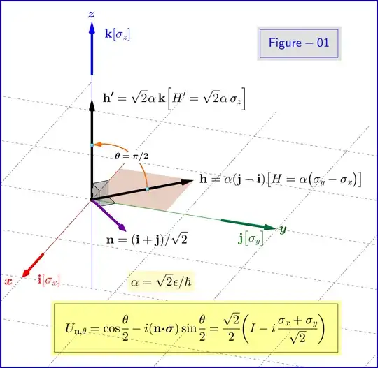

\begin{equation} H\boldsymbol{=}\alpha\left(\sigma_{y}\boldsymbol{-}\mathrm \sigma_{x}\right)\,,\quad \alpha\boldsymbol{=}\dfrac{\sqrt{2}\epsilon}{\hbar} \tag{01}\label{01} \end{equation} From the bijection between hermitian traceless matrices and real 3-vectors (discussed in paragraph ''The reasoning'' of aforementioned REFERENCE) the representative real 3-vector of this Hamiltonian is \begin{equation} \mathbf{h}\boldsymbol{=}\alpha\left(\mathbf{j}\boldsymbol{-}\mathbf{i}\right) \tag{02}\label{02} \end{equation} as shown in Figure-01.
If the Hamiltonian $H'$ of equation \eqref{01} must be transformed to a diagonal one $H'$ then we must have \begin{equation} H'\boldsymbol{=}c\,\sigma_{z} \,,\quad c\in \mathbb{R} \tag{03}\label{03} \end{equation} Above expression is justified because not only $\sigma_{z}$ is a diagonal hermitian matrix but moreover is traceless ($H'$ must be traceless since trace is invariant under similarity transformations).
To the transformed diagonal hermitian traceless matrix $H'$ there corresponds the representative real 3-vector \begin{equation} \mathbf{h'}\boldsymbol{=}c\,\mathbf{k} \tag{04}\label{04} \end{equation} If the transformation must be a rotation then the vector $\mathbf{h'}$ of equation \eqref{04} will be the image of the vector $\mathbf{h}$ of equation \eqref{02} so \begin{equation} \Vert\mathbf{h'}\Vert\boldsymbol{=}\Vert\mathbf{h}\Vert \quad \boldsymbol{\Longrightarrow} \quad c\boldsymbol{=}\sqrt{2}\,\alpha \tag{05}\label{05} \end{equation} that is \begin{align} H'&\boldsymbol{=}\sqrt{2}\,\alpha\,\sigma_{z} \tag{06a}\label{06a}\\ \mathbf{h'} &\boldsymbol{=}\sqrt{2}\,\alpha\,\mathbf{k} \tag{06b}\label{06b} \end{align} as shown in Figure-01.
The most simple rotation that brings the vector $\mathbf{h}$ on vector $\mathbf{h'}$ is around a unit vector $\mathbf{n}$ through an angle $\theta$ given by \begin{align} \mathbf{n}&\boldsymbol{=}\dfrac{\mathbf{i}\boldsymbol{+}\mathbf{j}}{\sqrt{2}} \tag{07a}\label{07a}\\ \theta &\boldsymbol{=}\dfrac{\pi}{2} \tag{07b}\label{07b} \end{align} shown in Figure-01. This rotation is represented by the following special unitary matrix $SU(2)$ \begin{equation} \boxed{\:\:U_{\mathbf{n} ,\theta}\boldsymbol{=} \cos\frac{\theta}{2}\boldsymbol{-}i(\mathbf{n} \boldsymbol{\cdot} \boldsymbol{\sigma})\sin\frac{\theta}{2}\boldsymbol{=}\dfrac{\sqrt{2}}{2}\left(I\boldsymbol{-}i\,\dfrac{\sigma_x\boldsymbol{+}\sigma_y}{\sqrt{2}}\right)\vphantom{\dfrac{\dfrac{a}{b}}{\dfrac{a}{b}}}\:\:} \tag{08}\label{08} \end{equation}
It could be verified easily, using the properties of Pauli matrices, that $U_{\mathbf{n} ,\theta}$ diagonalizes the Hamiltonian $H$, that is \begin{equation} U_{\mathbf{n} ,\theta}\,H\,U^{*}_{\mathbf{n} ,\theta}\boldsymbol{=}H' \tag{09}\label{09} \end{equation} or explicitly \begin{equation} \dfrac{\sqrt{2}}{2}\left(I\boldsymbol{-}i\,\dfrac{\sigma_x\boldsymbol{+}\sigma_y}{\sqrt{2}}\right)\,\left(\sigma_y\boldsymbol{-}\sigma_x\vphantom{\dfrac{\sigma_x\boldsymbol{+}\sigma_y}{\sqrt{2}}} \right)\,\dfrac{\sqrt{2}}{2}\left(I\boldsymbol{+}i\,\dfrac{\sigma_x\boldsymbol{+}\sigma_y}{\sqrt{2}}\right)\boldsymbol{=}\sqrt{2}\,\sigma_z \tag{10}\label{10} \end{equation}

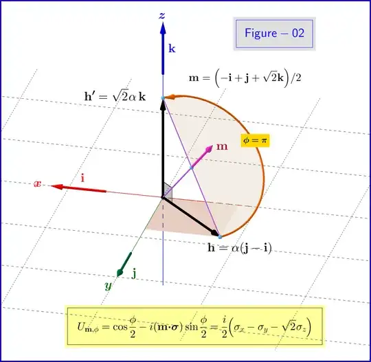

Note that as there exist infinitely many rotations that bring the vector $\mathbf{h}\boldsymbol{=}\alpha\left(\mathbf{j}\boldsymbol{-}\mathbf{i}\right)$ of equation \eqref{02} to the vector $\mathbf{h'}\boldsymbol{=}\sqrt{2}\,\alpha\,\mathbf{k}$ of equation \eqref{06b}, so there are infinitely many unitary matrices like that of equation \eqref{08} which diagonalize the Hamiltonian $H\boldsymbol{=}\alpha\left(\sigma_{y}\boldsymbol{-}\mathrm \sigma_{x}\right)$ of equation \eqref{01}. For example, a rotation around a unit vector $\mathbf{m}$ through an angle $\phi$ given by \begin{align} \mathbf{m}&\boldsymbol{=}\dfrac{\boldsymbol{-}\mathbf{i}\boldsymbol{+}\mathbf{j}\boldsymbol{+}\sqrt{2}\mathbf{k}}{2} \tag{11a}\label{11a}\\ \phi &\boldsymbol{=}\pi \tag{11b}\label{11b} \end{align} as shown in Figure-02 diagonalizes the Hamiltonian. The corresponging special unitary matrix is \begin{equation} \boxed{\:\:U_{\mathbf{m} ,\phi}= \cos\frac{\phi}{2}-i(\mathbf{m} \boldsymbol{\cdot} \boldsymbol{\sigma})\sin\frac{\phi}{2}=\dfrac{i}{2}\left( \sigma_x-\sigma_y-\sqrt{2}\sigma_z \right)\vphantom{\dfrac{\dfrac{a}{b}}{\dfrac{a}{b}}}\:\: } \tag{12}\label{12} \end{equation} Again, it could be verified easily, using the properties of Pauli matrices, that $U_{\mathbf{m} ,\phi}$ diagonalizes the Hamiltonian $H$, that is \begin{equation} U_{\mathbf{m} ,\phi}\,H\,U^{*}_{\mathbf{m} ,\phi}\boldsymbol{=}H' \tag{13}\label{13} \end{equation} or explicitly \begin{equation} \left[\dfrac{i}{2}\left(\sigma_x-\sigma_y-\sqrt{2}\sigma_z \right)\right]\,\left(\sigma_y\boldsymbol{-}\sigma_x\vphantom{\dfrac{\sigma_x\boldsymbol{+}\sigma_y}{\sqrt{2}}} \right)\,\left[\boldsymbol{-}\dfrac{i}{2}\left(\sigma_x-\sigma_y-\sqrt{2}\sigma_z \right)\right]\boldsymbol{=}\sqrt{2}\,\sigma_z \tag{14}\label{14} \end{equation}
