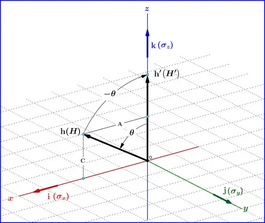

For convenience in order to simplify the equations let ignore the constant $\:-\frac12\:$ so that we have the Hamiltonian \begin{equation} H=\mathrm A\sigma_{x}+\mathrm C\sigma_{z}\,,\quad \mathrm A=E_J\,, \:\: \mathrm C=\left[4E_c\left(1-n_g\right)\right] \tag{01}\label{eq1} \end{equation} We must find a rotation in real space $\:\mathbb{R}^{3}\:$ so that for the new Hamiltonian \begin{equation} H'=\mathrm B\sigma_{z} \tag{02} \end{equation} The rotation must be(1) around the $\:y-$axis through an angle $\:-\theta\:$ represented by the following special unitary matrix
\begin{equation} \!\!\!\!\!\!U=\cos\frac{\theta}{2}I+i\sin\frac{\theta}{2}\sigma_{y} \,,\quad \theta =\arctan\left(\dfrac{\mathrm A}{\mathrm C}\right)= \arctan \left[\frac{E_J}{4E_c\left(1-n_g\right)} \right]\,,\quad \theta \in [0,\pi] \tag{03}\label{eq3} \end{equation} In the following $\:\omega=\frac{\theta}{2}:$
\begin{align} \!\!\!\!\!\!\!\!\!\!\!\!\!\!\!\!\!\!\!\!\!\!\!H'&\!\!\!\!\!\!\!\!\!= UHU^{*} =\left(\cos\omega I+i\sin\omega\sigma_{y}\right)\left(\mathrm A\sigma_{x}+\mathrm C\sigma_{z}\right)\left(\cos\omega I-i\sin\omega\sigma_{y}\right) \nonumber\\ & \!\!\!\!\!\!\!\!\!= \left(\mathrm A\cos\omega \sigma_{x}+i\mathrm A\sin\omega\sigma_{y}\sigma_{x}+\mathrm C\cos\omega \sigma_{z}+i\mathrm C\sin\omega\sigma_{y}\sigma_{z}\right)\left(\cos\omega I-i\sin\omega\sigma_{y}\right) \nonumber\\ &\!\!\!\!\!\!\!\!\! = \mathrm A\cos^{2}\omega \sigma_{x}-i\mathrm A\cos\omega\sin\omega\sigma_{x}\sigma_{y}+i\mathrm A\cos\omega\sin\omega\sigma_{y}\sigma_{x}+\mathrm A\sin^{2}\omega\sigma_{y} \sigma_{x}\sigma_{y} \nonumber\\ &\:\!\!\!\!\!\!\!\!\!+\mathrm C\cos^{2}\omega \sigma_{z}-i\mathrm C\cos\omega\sin\omega\sigma_{z}\sigma_{y}+i\mathrm C\cos\omega\sin\omega\sigma_{y}\sigma_{z}+\mathrm C\sin^{2}\omega\sigma_{y} \sigma_{z}\sigma_{y} \nonumber\\ &\!\!\!\!\!\!\!\!\! \!=\!\mathrm A \left(\cos^{2}\omega\!-\!\sin^{2}\omega\right)\sigma_{x}\!+\!2 \mathrm A\cos\omega\sin\omega\sigma_{z}\!-\!2 \mathrm C\cos\omega\sin\omega\sigma_{x}\!+\!\mathrm C \left(\cos^{2}\omega\!-\!\sin^{2}\omega\right)\sigma_{z} \nonumber\\ &\!\!\!\!\!\!\!\!\!\! =\left(\mathrm A\sin\theta+\mathrm C \cos\theta\right)\sigma_{z}+\left(\mathrm A\cos\theta-\mathrm C \sin\theta\right)\sigma_{x}=\left(\mathrm A\sin\theta+\mathrm C \cos\theta\right)\sigma_{z} \tag{04}\label{eq4} \end{align} that is, see equation \eqref{eq11}(2)
\begin{equation} H'=\sqrt{\mathrm A^{2}+\mathrm C^{2}}\:\sigma_{z}= \sqrt{E_J^{2}+\left[4E_c\left(1-n_g\right)\right]^{2}}\:\sigma_{z} \tag{05} \end{equation}

In the Figure below we see the vectorial in $\:\mathbb{R}^{3}\:$ representation of the $2\times2$ hermitian traceless matrices $\:\sigma_{x},\sigma_{y},\sigma_{z},H,H'$.
