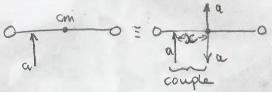

If the line of action of the force is is not through the centre of mass you can transform the original force $\vec a$ by adding two forces $\vec a$ and $-\vec a$ (net force zero) acting at the centre of mass as shown below:
You can now consider these three forces as follows:
a force equal in magnitude and direction to the original force but passing through the centre of mass.
This force will produce a translational acceleration of the centre of mass of the object.
and
a pair forces equal in magnitude to the original force with one in the same direction as the original force and the the other one in the opposite direction.
This pair of forces is called a couple and produce a torque of $ax$ which is independent of any axis of rotation that you may choose.
A couple only produces rotational acceleration.
If the original force is through the centre of mass no couple is produced and so the object does not undergo rotational acceleration.
