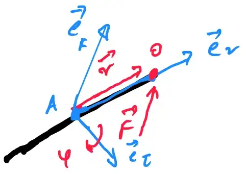

the torque $~\vec\tau~$ is
$$\vec\tau=\vec{r}_{Ao}\times \vec F=r\,F\,\underbrace{(\hat e_{Ao}\times \hat e_F)}_{\hat e_\tau}$$
where A is arbitrary rigid body point
thus the rotation of the rigid is at point A about the axis $~\hat e_\tau$
