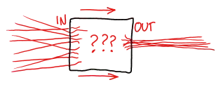

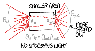

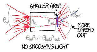

Maybe you can't overlay light rays, but can't you, you know, sort of smoosh them closer together, so you can fit more of them side-by-side? Then you could gather lots of smooshed beams and aim them at a target from slightly different angles.
Nope, you can't do this.
It turns out that any optical system follows a law called conservation of étendue. This law says that if you have light coming into a system from a bunch of different angles and over a large "input" area, then the input area times the input angle equals the output area times the output angle. If your light is concentrated to a smaller output area, then it must be "spread out" over a larger output angle.
In other words, you can't smoosh light beams together without also making them less parallel, which means you can't aim them at a faraway spot.
But the spot doesn't have to be faraway. From the diagram above, one could perhaps hold a piece of paper extremely close to the smaller area, so that even though the light is more directionally spread out, it doesn't matter because it hits its target after a negligible distance.
It seems to me that this effect isn't important -- one should be able to focus the sun/moon to a higher temperature based on this principle.
Why doesn't this argument work?

I thought the same thing at first (and even emailed Randall) but finally realized that the angle upon exiting the system played a role in how much energy gets absorbed by the stuff you're focusing on. If it enters a surface at an extreme angle, it's likely to exit the region we care about very quickly, before impacting anything.
I think it works in the other direction too; that higher temperature sources are required to produce light that's less spread out. So even if you could somehow get all of the light coming from the moon lined up nice and parallel for free, so that when it passed through your giant lens it came out the other side with a lower etendue (and thus higher ability to hit stuff in the desired region) you still wouldn't have found a way to make a spot on the earth hotter than the surface of the moon -- you'd simply have raised the effective temperature of the moon. AND built an awesome giant moon-laser.
EDIT:
Randall is using conservation of etendue wrong. Higher temperature sources radiate light with lower etendue. Lower etendue light is better absorbed by targets. Conservation of etendue is what enforces the second law, in this situation. His explanation seems to assume that the energy transferred only depends on the number of photons reaching the target area (and so his appeal to a dubious "aim them at a faraway spot.") But it also depends on etendue. The photons exiting the system in his diagram are already more likely to be reflected or scattered, no matter how close you place your target.
