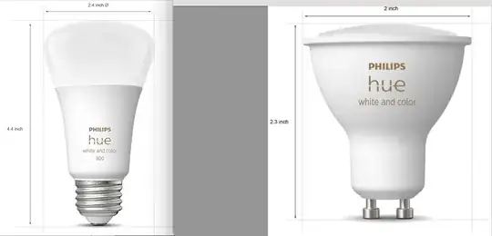

I have two main bulbs I could do this with. And I realize that my biggest roadblock is this law. Which in my layman's term is saying that these light sources start as diffuse so you will not be able to make them not diffused. enter image description here
